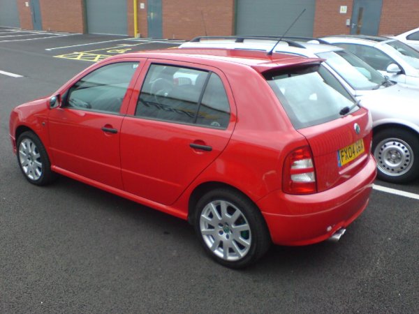

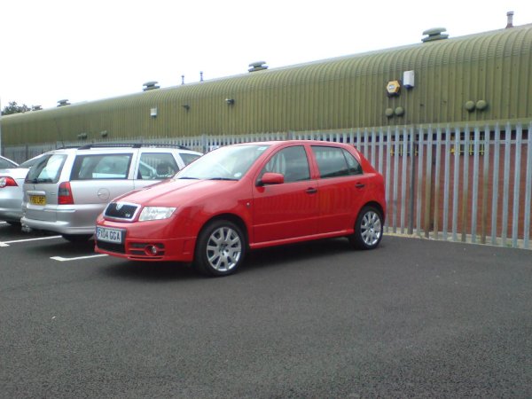

Well, the plan was to sell off the vectra C and the vectra B estate that we were using as company cars and buy something that is both big enough to tow a car on a trailer and carry lots of tools/engines etc... and was still comfortable and modern that wouldnt be modified at all, ever.. But that plan failed and I bought a Skoda :|
As soon as I saw it I knew I would buy it, the car is 100% immaculate in every way, 1 owner, serviced since new at Horton Skoda, and I knocked the dealers down by over £1200 to get a deal that I couldnt refuse. It isnt an ideal car for towing a trailer, too clean to use as a company car and not ideal for carrying tools and engines around but I bought it anyway.

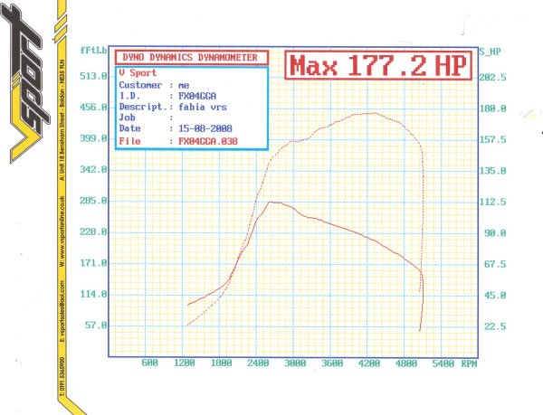

I also failed on the plan for keeping it standard, within 24 hours of buying it I remapped it. nothing drastic, just a nice increase in power, smooth torque that wont kill the clutch and plenty of economy throughout the map. on a 70mph run it will average 65-70 mpg

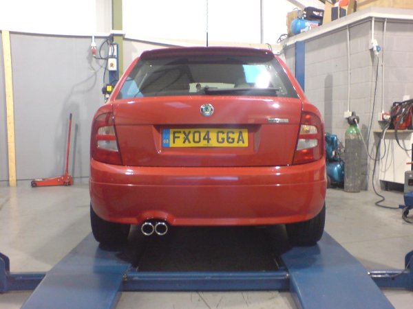

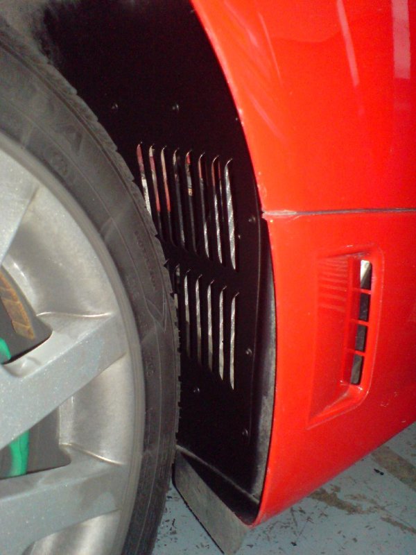

The only part of the car which was looking a bit rough was the exhaust, it was still the original 4 year old standard one and the hangers werent ideal so on went a 2.25" single box stainless one that we built from leftover bends and bits from the scrap box and a tailpipe that a customer had ordered months ago but then changed his mind, but it was perfect for the Fabia:
Now the exhaust was sorted we concentrated on the intake system. During the mapping we couldnt get the fuelling right and couldnt work out why it would smoke so badly under load before coming on boost, we had never had an issue on these engines in the Golfs and audis etc... So we measured the intake air pressures at the airbox as they are very different on the Fabias to some of the other PD130 engines. We found that under load before it hits peak boost the airbox was under massive pressure and the turbo simply couldnt draw enough air through it. So we modified the airbox to releave this excess pressure and it now boosts more smoothly, fuels correctly and no more black smog

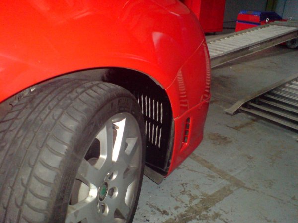

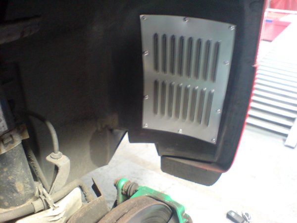

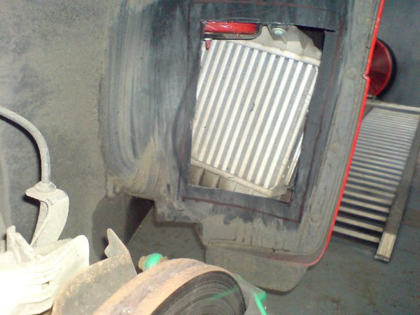

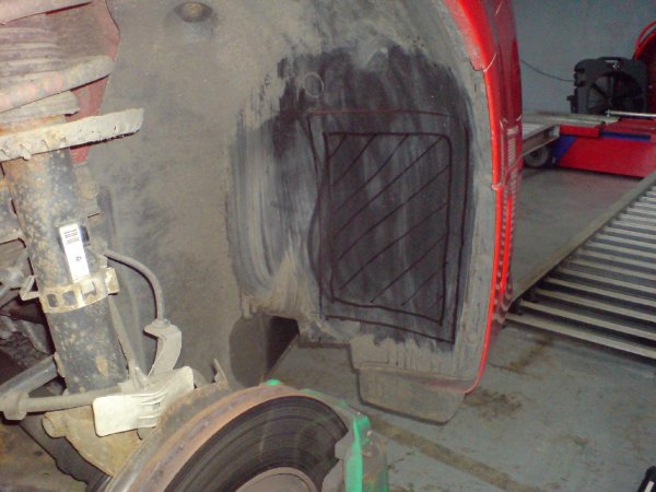

Next up was the intake temps, the SMIC (side mount intercooler) is more than up to the job but its position is poor in the drivers side wheel arch. The audi TT have the same positioning but they also have a wheelarch liner with vents in. As you can see from these pics there is nowhere for the hot air to go after it has passed over the intercooler. So out with the marker pen and after some rushed getto modding style measuring and marking up we had this:
out with the air cutter:
B&Q air vent (£3.29) :
a good clean up and some halfords satin black:
I did a data log of the ambient temps vs inake temps before bodging the vent in, am yet to do a log after, but it can only help things.
Next on the list is some new suspension (probably Bilstein) and some decent brakes. Suspension may be done tomorrow, and if I get time possibly the brakes as well

Nice work - all highly recommended mods, as well as being effective - as you're proving

that is a good idea with the grill there. Ill have to do that myself

were did you puchase the grill from ??

Quote:
Quote:

Looking at your dyno graph mate the torque drops of quite alot any reason for this ? mine holds good torque all the way through to like 4000 rpm
cheers
shaun
Good point, the graph is actually incorrect, it was one we printed off during mapping before we had sorted the boost in the later revs, thanks for pointing it out. I will get the correct graph up later.
