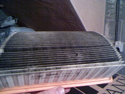

Basically, I’ve had the car for 7 months now (‘55 vRS) I’ve done 6-7k in that time. The car was newly serviced when I had it, just had it’s 30k service.
Over the last 7 months, I’ve noticed the fuel consumption gradually worsening. All styles of driving are affected, from motorway slogs to the regular work run. Both the mpg trip computer thing (which I don’t trust and always overstates economy), and quite simply, the number of miles from a tank have been getting worse.
I used to get 475-500 miles to tank on everyday driving, I now get 375-400. Over the last 7 months I’ve used a mix of fuels, from premium diesel (with marginally better economy) to supermarket juice, both with and with out a shot of millers.
It’s not happened overnight, it’s a gradual drop off.
Any thoughts please??? I’m reasonably sure that my right foot hasn’t got any heavier, and my tyres are correctly inflated. I’m thinking maybe filters are getting dirty, small fuel line leak……….? I really haven’t got a clue as I have the mechanical ability of a 7 year old girl. (That’s perhaps a bit harsh on the 7 yr old girl)
Many thanks in advance for your suggestions.

Very likely that the air filter is showing its age. The recommended change is at 40K so it may well be on the original. A new one is under a tenner from Halfords. Most posters here agree that 40K is too long and 10K is more sensible. I changed to a cleansable Pipercross and clean it every 10K.

So it seems like a new filter is needed. Thanks folks.

Service schedule states to replace the air filter at 40K!!! Which is a stupidly high number considering it a simple paper element. And costs next to nothing
Also, now we're into cold weather, the diesel on sale will be "winter diesel", which has less shove per bang than the normal stuff but resists waxing better.
Also, also, try doing the "Cage" mod. <Do a search and listen to Basil>
Also, also, also... Other things to consider... tyres, tyre pressures, wheel bearings, brakes, can all have a bearing <groan> on rolling resistance and hence economy.

On the filter front, I too agree 40k is far too long for an induction filter. I've posted this before, but this was my filter after just 15k:
My fuel consumptions a bit worse than normal, but I think that has more to do with the Dragon box I put on a few months back! Still >400 miles out of a tank, though!
