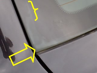

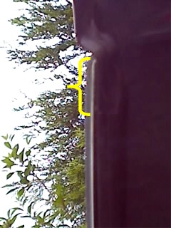

Time for some more of my (in)famous cameraphone pics!
I had a look at what's going on with my back window, and there are definite areas where the black paint has faded, in the bottom corner (arrowed), and in a narrow line, about 1" in from the edge, right the way up the window (bracketed):
Lifting up the boot lid, you can just about see that the black paint's more-or-less disappeared in the bottom corner (bracketed area again - look for the pale flecks):
I reckon that it's got like that because of either something I'm using to clean the car, or the stuff I've got in the washer reservoir. I also reckon the line up either side of the window marks the edge of the sealant, and the mystery liquid's running down, taking the paint with it. The good side of that is that it seems to stop at the sealant, so isn't leaking in!
My claim that "I've used non-VAG washer fluid for years, and it hasn't done me any harm" may be coming back to haunt me, but as long as it's just cosmetic I'm not all that fussed...

I had my rear window replaced under warrenty. It was exactly the same as the one in the pic above. I would guess it would come under the paint and bodywork warrenty?

Yep apparently happens a lot with the Seats. It's not the glass coming unstuck, it's actually delaminating (Coming apart).
I have just had mine replaced under warranty today by the dealer for exactly this.
I'd love to know how your dealer came to the conclusion that the toughened glass in your rear window was delaminating... Toughened glass and laminated glass are two completely different things. And it even says what kind of glass it is on the little label in the bottom corner ("Laminated" for the windscreen, and "Solid Tempered" - aka Toughened - for all the other windows.)
If the dealers are prepared to replace the glass under the paint and bodywork warranty, then that's great. But there's no need to come up with implausible explanations for what's caused it. It's just the black paint coming off, I don't think it can be anything else, and in fact I'm willing to stake money on the fact that it's nothing to do with delamination.

Is laminated where it has a layer of plastic covering the glass to stop it shattering when broken? If so, then wouldn't this not be possible on a rear window as that's not laminated. Or is it?

The laminated glass in your windscreen has a thin layer of plastic (polyvinyl butyral to be precise) between an inner and outer layer of toughened glass. This means that if a stone hits your windscreen, you won't be covered in tiny shards, as you would do with plain toughened glass. The side and rear windows of your car don't have this intermediate plastic layer, but are still toughened, basically because you need the glass to be stronger than normal glass, and to shatter safely when it does break, but the chance of it breaking under normal driving conditions (i.e. a stone impact) is so small that going to the lengths of fitting laminated glass isn't justified. You can retrofit a layer of sticky-backed plastic to the inside of the glass for added security, but this has the disadvantage of making it harder to get out if you have an accident and can't open the door (another reason for not fitting laminated glass except in the windscreen).
But enough of the science lesson. I know for a fact that my car doesn't have any security coatings, and yet the black stuff's coming off. I suppose you could call the black stuff a "laminated layer" (technically it's a coating, because it's on the outside), but it's got nothing to do with the integrity of the glass itself, as Decron's dealer has indicated. I suspect it's purely there for cosmetic reasons (otherwise you'd see a squidgy layer of sealant all the way round the front and rear screens), but it might also be there to assist the sealant sticking to the glass. I doubt this, however, and the areas where the black stuff's coming away from the glass isn't where the sealant is, anyway (hence, I was able to take that pi$$-poor photo from the underside, looking straight though!) Plus, there's no black stuff behind the rear-view mirror on my Fabia, and that's stuck pretty darn firmly to the screen - yet other cars do have black stuff surrouning the place where the mirror's attached.
In case you hadn't already guessed, I'm convinced it's a cosmetic issue only and nothing to do with the glass coming apart in any way. Like I've said before, if it bugs you that much, and the dealer will replace the screen under warranty then go for it, but don't be worried that your rear window is about to implode if you don't!!!

Well, the car went in to have the rear window bonding looked at today (FR Pulleyns in York) and I've been told that it's not covered under warranty.
This isn't the original warranty, but the extended one that I got with the car through buying it from a dealer in January (it's an 04 plate). Just goes to show it's not worth the paper it's written on.
They suggested I try my insurance for glass cover.
