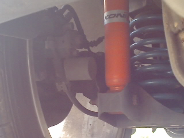

Well this is what my rear calipers look like:
...compared to...
(Hope it's OK to repost your image, FAST FITZ :thumbup: )
Seeing how what I thought was a new piston is clearly on the wrong side of the handbrake arm, I'm now betting that it's just a shroud for a spring similar to the Audi part. What price a spring straight out of the factory, eh? :rotz:
