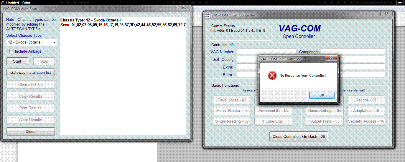

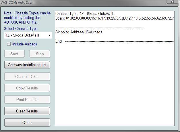

Hi guys,
After a bit of help if possible please...
Engine management warning light came on this morning on the way to work (Octavia VRS petrol, MKII), car felt fine but thought I'd get it checked out. One of the other guys here has an A3 and has got a copy of VAG COM (version 409-1, a pretty basic one I think) so we ran a scan. The lead is marked 'OBD II' I think, fitted perfectly into the port and the green light on the lead came on. For each module it tried 4 scans before moving onto the next one which seemed a bit odd.
The auto-scan result is shown below:
http://www.tartybikes.co.uk/media/car/vagcom1.jpg
Then tried a direct scan of the engine module (01) and this was returned.
http://www.tartybikes.co.uk/media/car/vagcom2.gif
This is the first time I've used the software and I'm not familiar with it, but it seems like it's not connecting properly?
Any help greatly appreciated!
Cheers
Adam

The MKII Octavia is CAN based meaning you will need a genuine Ross-Tech interface

Of course - good point! Looks like your auto-scan actually failed, rather than coming back with no results... :doh:
