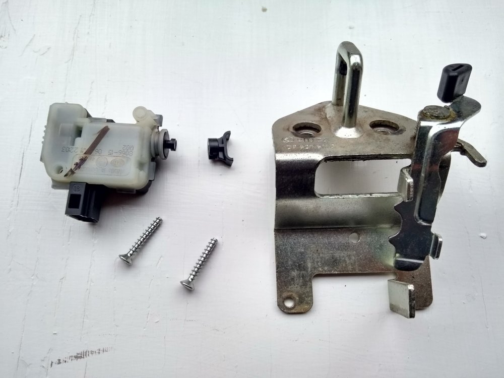

I came across this topic when looking for help when my tailgate would not open, and I thought I'd share my findings.
My car is a 2012 MK2 Octavia Estate, and the tailgate would not open with either the release on the tailgate, or the button on the key fob.  No whirring, no nothing.  I ended up removing the lower trim around the to expose the solenoid motor, unplugging the connector and testing it with a multi-meter.  I was getting the expected pulse of 12V when the button or fob were operated, so the problem was a dead motor.
My investigations revealed that where the MK1 has a Skoda part number for the motor and is available separately, the MK2 does not.  I decided to play it safe, and bought a new old-stock replacement part 1Z9 827 511C.  That is fitted and I can open my tailgate again.
Having fixed the problem, it was time to take a look at the broken part.  I think it is feasible to replace the motor, despite not being listed as a part by Skoda.  The motor is a generic Hella part, and appears in many eBay listings for around £10.  As you can see from the photo the motor is attached from the rear using plastite screws with torx heads.  The saddle used to operate the cam just clips on/off.  So replacement would be unbolt the assembly, remove the old motor, transfer the saddle, and reassemble with a new motor.
Nick
