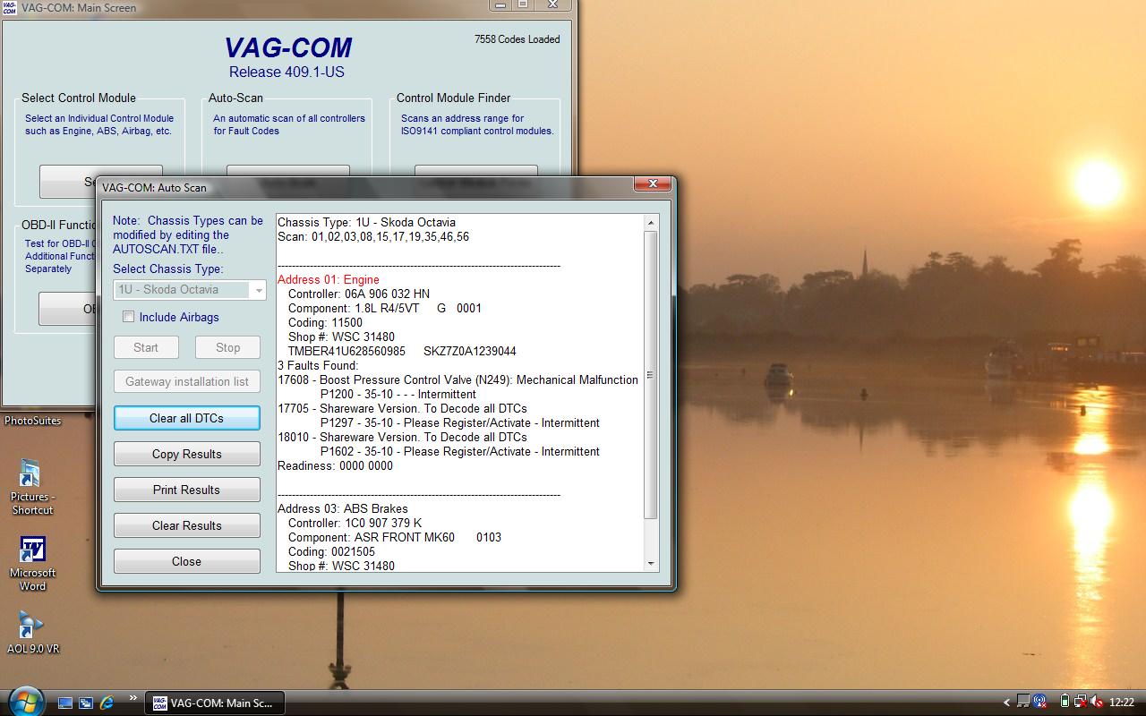

can anyone enlight me me to what codes I have and do I have need for concern?
Presuming one was when I was running an atmospheric DV which I recently changed for a recirculating one
Thanks in advance

The first is probably from the DV.

just found these
17705/P1297/004759 - Pressure Drop between Turbo and Throttle Valve (check D.V.!)
17608/P1200/004608 - Boost Pressure Control Valve (N249): Mechanical Malfunction
18010/P1602/005634 - Power Supply B+ Terminal 30: Voltage too Low
first one down to atmospheric DV that has since been changed?
second one?????
third one down to battery dieing and then been replaced just after christmas?

Take a look here:
Ross-Tech fault codes
They are all covered :thumbup:
Cheers for that found it on the Ford Galaxy owners club about 15 minutes ago :thumbup:
