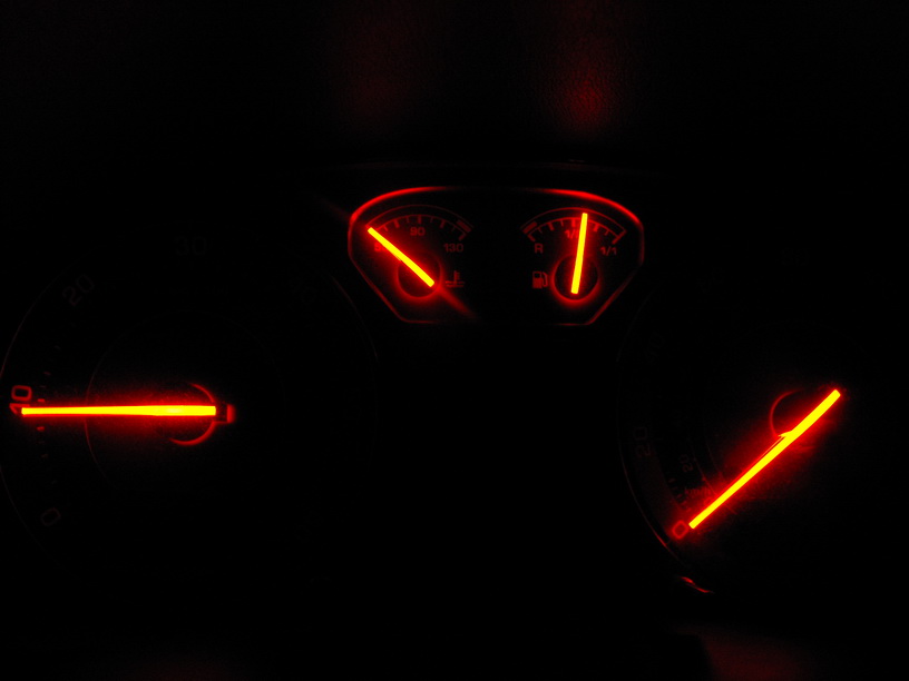

Needles only

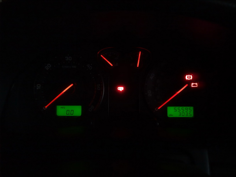

Needles and LCD displays

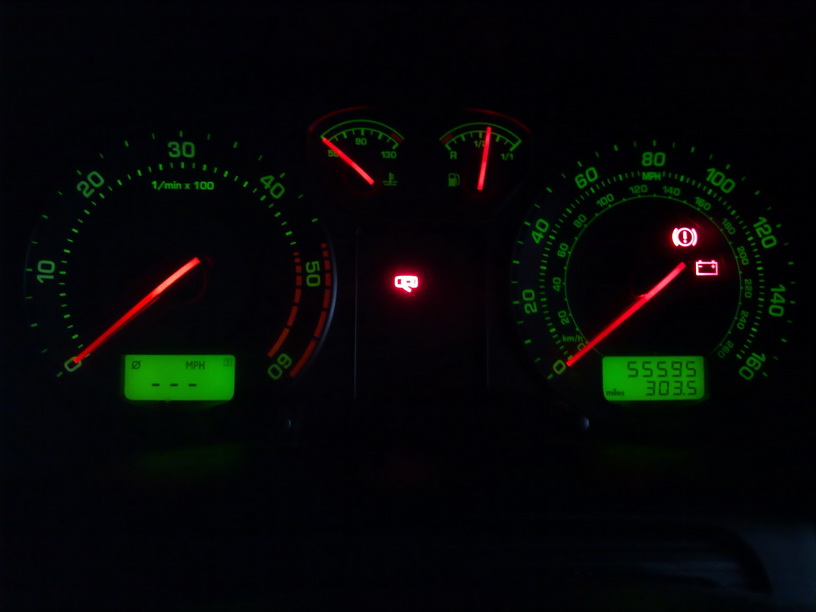

Needles, LCD displays and dials.
