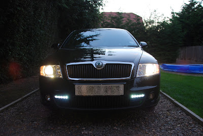

These are them fitted. Ignore the holes as thats where i removed the others from and i am picking up some new grilles tomorrow.

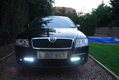

Now a pic of them Working - massive difference.
And just to show by comparison the difference to the old ones
So im am well chuffed. The guy who runs the company i had a chat with today and he sent me some pics of them fitted to a Porsche so if they are good enough for Porsche they are good enough for me.
Also for £45 delivered i am well impressed versus the £200+ for OEM style EACH. I've ordered another set for the Silver Slingshot which will be here tomorrow.

The photos make it look like they are dazzling. However i was crouched right down when i took these. Once i have got them fitted with the New Grilles i will take a picture at driver level so you can see what they look like. Coincidentally My neighbour has an A5 and they are no brighter than his DRL's. Plus as they are lower they wont dazzle other drivers etc & are far enough away from Indicators to not cause a problem :thumbup:
