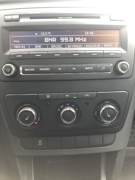

Hallo Great Yeti,
Yesterday 11/19/2020, I found your posts with the instructions plus explanatory photos on how to build out the radio.  I have a Yeti 1.2Tsi from 2010 and would like a workshop manual or something similar to be able to do some maintenance and minor repairs myself.  That is why I am looking for such documents and I would like to know where you found them.  Would you like to let me know?  My e-mail address is [email protected].
Kind regards, Arjen.
