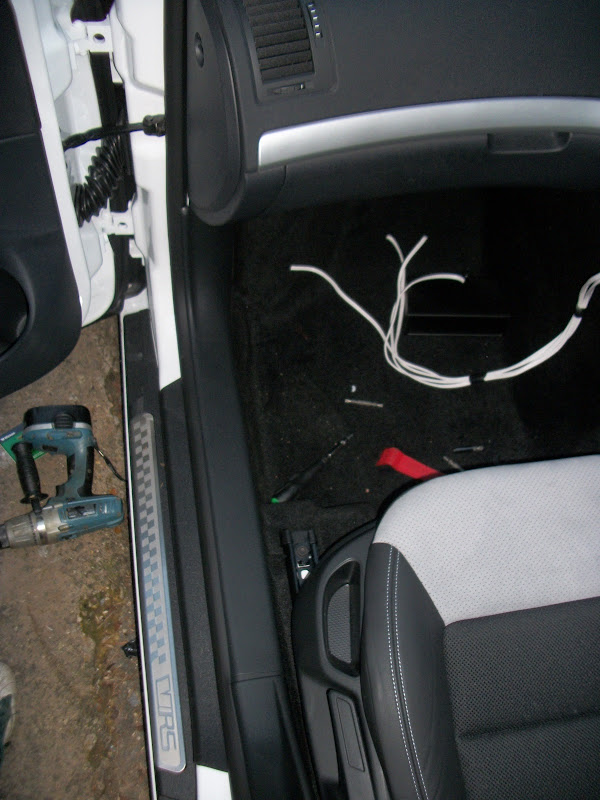

Remove the door cards (big thanks to humsk for THIS guide to the door card removal - worked a treat and had NO snapped clips!)
Im sure the use of the red trim removal tools helped make sure nothing got snapped or broken - a very worthwhile investment especially on a brand spanker!
Drilled out the rivets holding the OEM speaker in then popped them through
Mounted the new speakers to the adaptor and then using self tappers to mount it all to the door

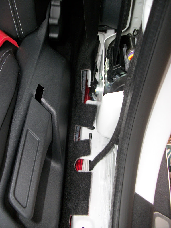

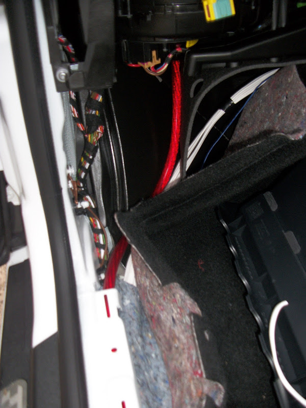

Next I needed to run 0awg power cable - having done this in an A3 and Seat Leon I knew the quickest way was through the bulkhead behind the battery. So needed to remove the glovebox and the battery for easy access

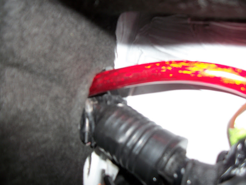

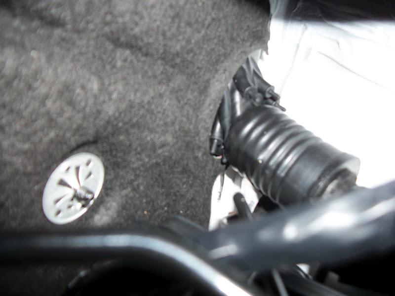

The target for the cable
to pass the cable through I taped it to a steel coat hanger and covered it with WD40 and pushed
et voilà! one cable protected by the OEM grommet

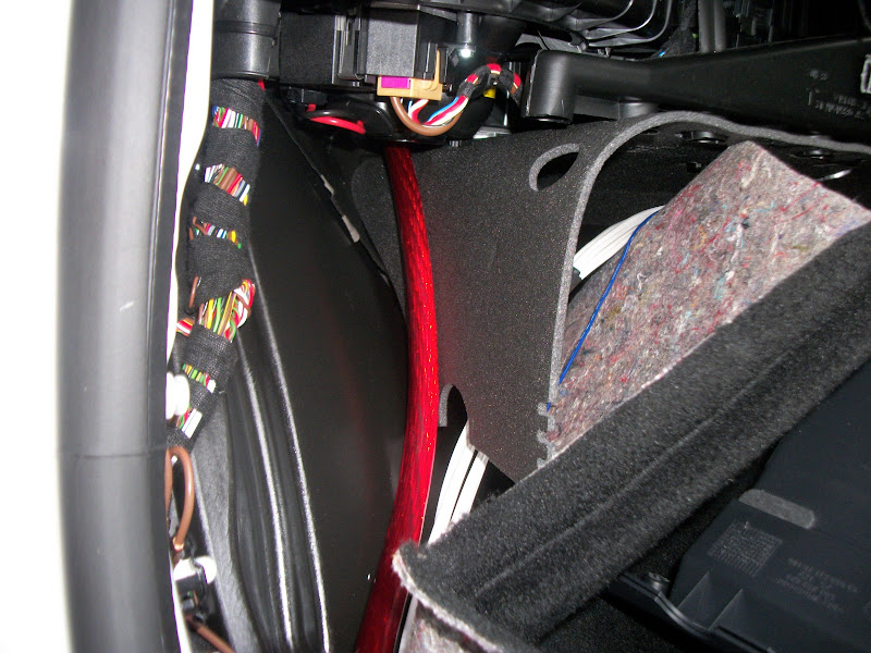

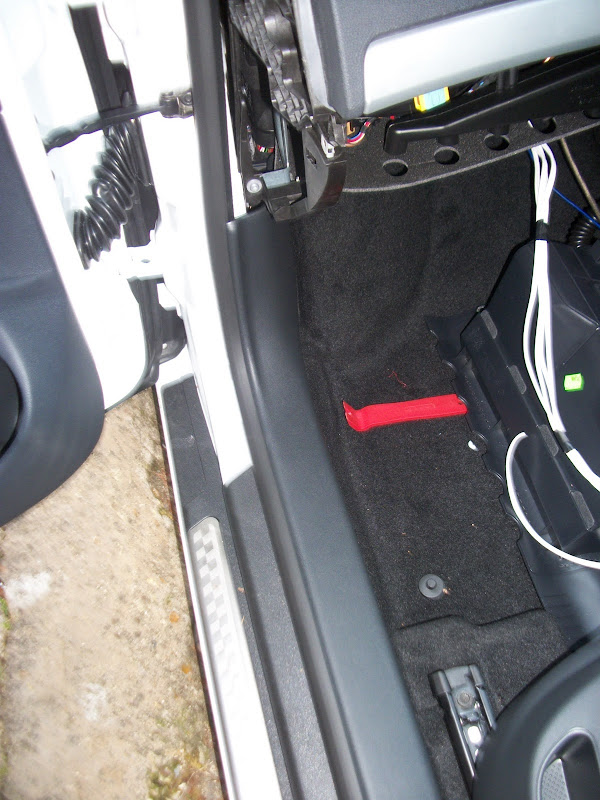

The power then ran down the passengers side of the car with the speaker,rca and remote cables

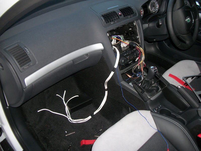

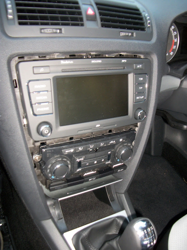

Then I tackled the Stock Bolero HU
All the cables came up through the dash no problems - you can see the white speaker cables (rather than running speaker cables into the doors I am just tapping into the factory loom via a modified quadlock adaptor, im not running massive power so utilising what is already there made it much simpler
took the climate control panel off to allow me to run the sub cable for my Ipod into the lower centre console cubby hole
Then all back together

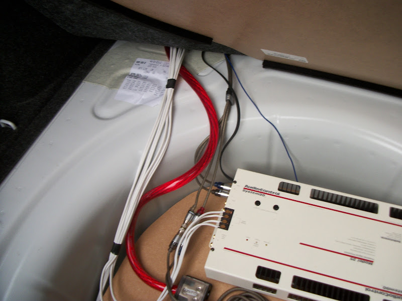

All of the cables ran into the boot

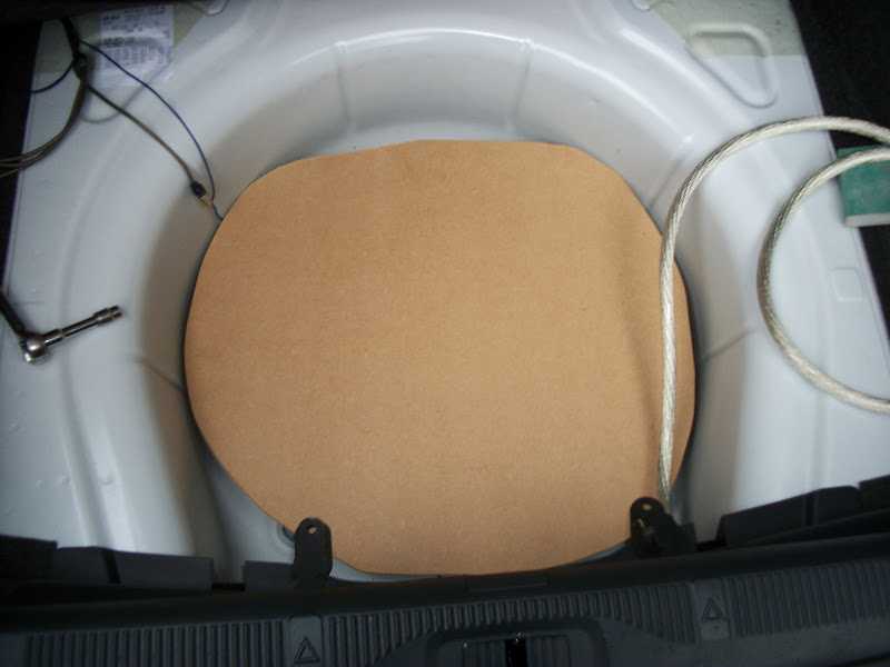

I cut a template out to fit the wheel well and test fitted the amps
Then cut the MDF
Was thinking about how best to secure the board to the wheel well floor on a temporary basis - one thought I had was getting hold of an OEM retaining bolt from skoda but being attached to my kidneys i didnt want to sell one for the sake of it so in lookin in my toolbox found a nice wide flat headed bolt that fitted nicely in the recess
Place some blocks of wood under the board to bring it up level (due to the spare wheel bracket not sitting flush with the wheel well bottom - drilled a hole in the board - lined up the bolt and dropped it on

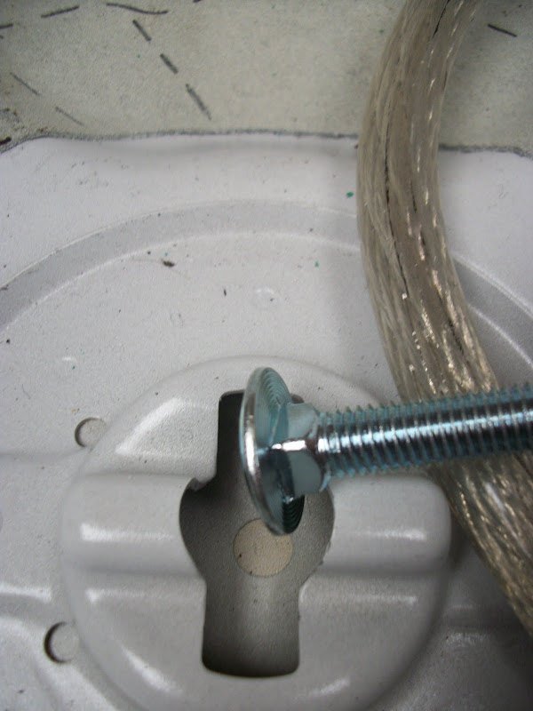

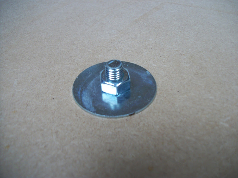

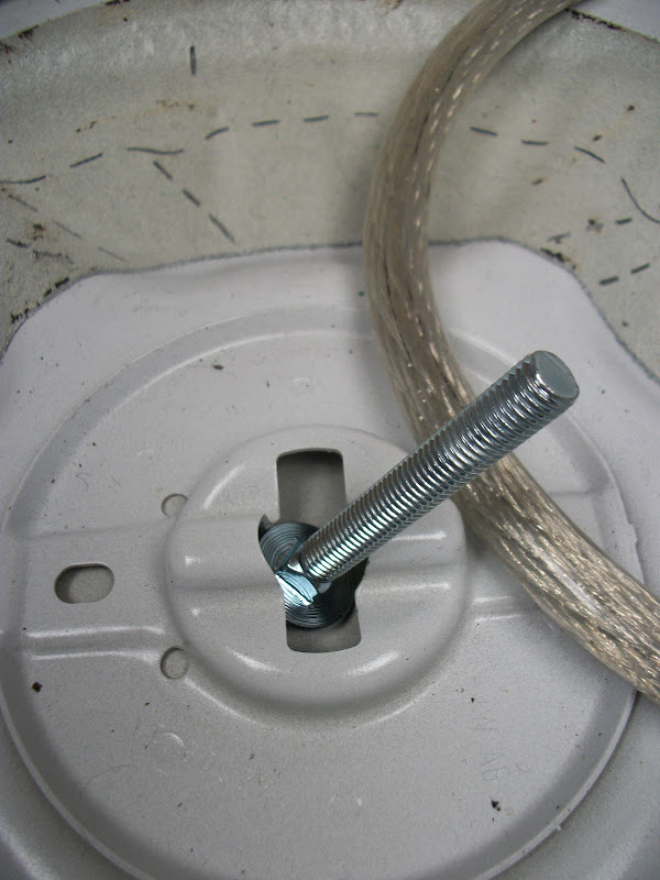

at this point I reminded myself over and over that this was an earth point (so as to avoid any accidents when I started running the power cables) - but not a good enough one for the whole system , for that i took some sand paper to the slam panel trim mounting bolts, down to baremetal
some washer to ensure secure contact then bolted it back up
I then mounted the amps and the power connectors
and all wired up

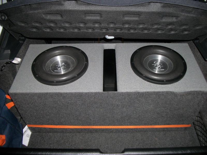

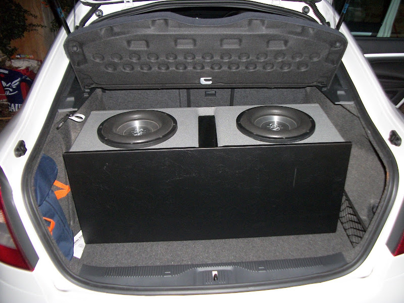

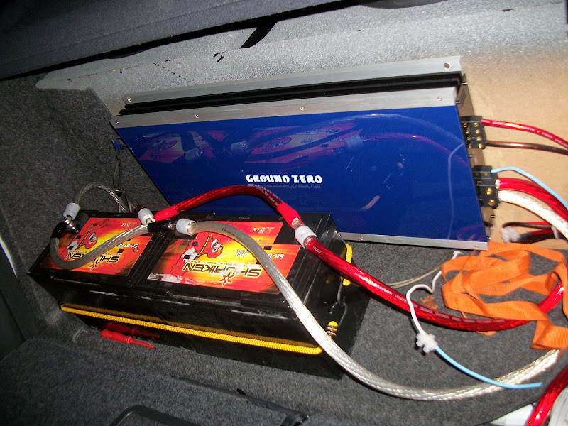

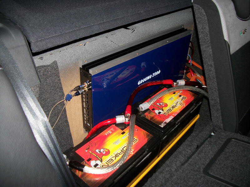

I am still waiting on delivery of the subwoofer amp but picked up the sub box last night - It just fits between the arches so a great fit

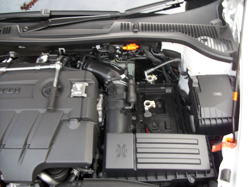

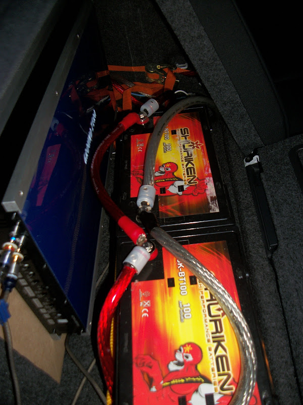

Once the amp arrives I will be adding a 2nd battery and wiring in the amp - eyes peeled for more updates
First impressions are great - its loud and clear - I have some cross overs built into the amps Im using so midbass is lacking (more for the protection of the OEM speakers and due to the lack of sound deading) I have also kept the Stock tweeters wired in so that the stage isnt dragged back too much - I like it a lot
With the subs in im hoping to do 145db - Im taking it to Belgium for a competition in December

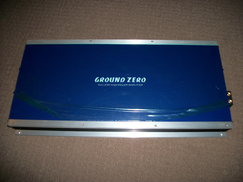

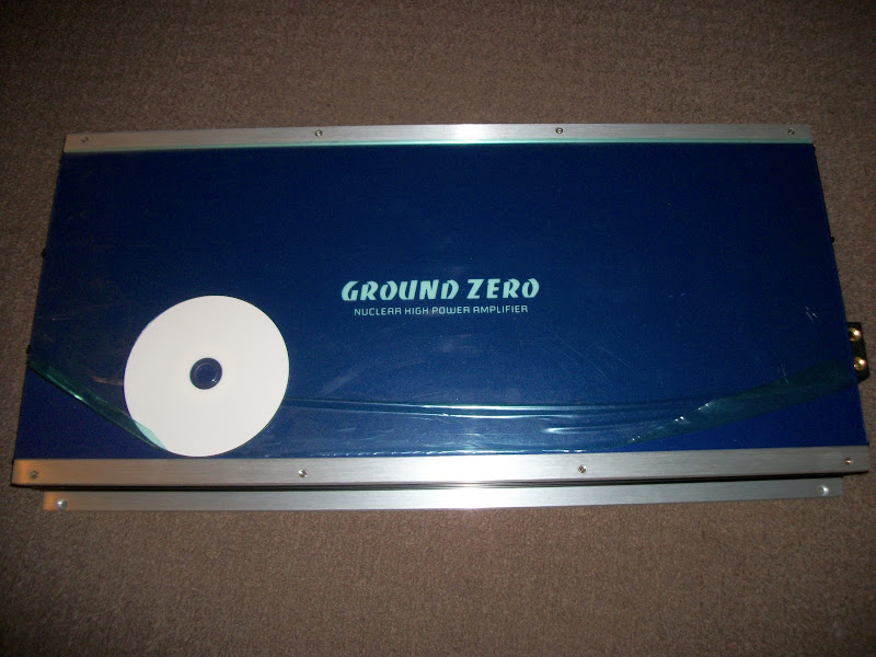

Not sure if anyone is interested but My sub amp arrived today, its a Ground Zero GZNA2800XII
its a bit of a beast -
2 x 1200wrms @ 1ohm per channel (for music it will play fine at 0.5ohm per channel)
or 1 x 2400wrms @ 2ohm

Awesome shizzle there dude, looks like the ground retaining nut is plastic though?

Yup it is - but its only job is to press the crimp agaisnt the bare metal underneath - there is a washer pressed flat against the bare metal work then the crimp then the nut compresses it all for a good contact

The finished article
And behind the trim panel is the ratched strap holding it all down
The business side
The GZNA2800XII is about a 1.5 times the size of the 2500s in big black - its certainly a beast - as you can see i got a pair of shuriken bt100s in as well - I had them lying around so might as well use em
It certainly shifts some air - the box is probably low 30s tune and the 2nd note in put on appears the loudest - didnt get a chance to properly set up but will have another pop tomorrow

Any reason for running two batteries in series, as opposed to say 1 battery and a farad capacitor ?
( I notice you don't seem to have a split charger either )

I used two batteries because I had them
Capacitors are useless in all but the top end SQ systems - they are an extra drain on a systems power supply - the batteries I use can supply enough current fast enough to keep up with the music - capacitors are a total waste of money
Split charge is only needed if you need to isolate your starter battery from your system battery and running with your engine off - for shows etc (one should also be used to isolate two batteries of differing conditions to prevent a knackered battery from draining a working one - in my system all 3 batteries are of a similar age n state so thats not a worry)
