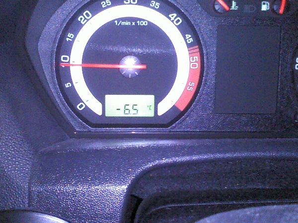

What's wrong with this picture?
Not noticed this before, but...
..although I got a bong and a snowflake once it had 'warmed up' to -5! :giggle:
yep same problem here this morning - no bong until -5C
-8C when i started the car - frost on the inside of the windscreen!
I'm used to having no bong and a flashing temperature when I first start the car on a chilly day, but today there was nothing! :wonder:

In my old 206 and my mates focus it only warns of ice between +3' and -5' as anything below that is obvious there is going to be ice/ frost, so it only warns you in the milder incase you haven't noticed... Probably same with skoda...

on my focus st it shows an orange snowflake at -3 and then a red snowflake at 0 and lower
LOL, I noticed this on the Fabias I've had too! It's as if it looses the ability to tell it's cold below a certain temp :D
Or that below that level it's pretty bloody obvious that ice may be a potential risk anyway ;)
I think this is a case of the Germans letting natural selection run it's course.. if it's that cold and you don't think that there might be a risk of ice then.. let Darwin's theory prove itself basically.
It's perfectly clear in the handbook:
The outside temperature indicator will appear with a snowflake symbol (warning
signal for ice on the road) ⇒ page 14, fig. 8 and a warning signal sounds* when the
outside temperature lies between +5°C and -5°C.
Clearly you'll know it's icy if it's less than -5°C
The picture above says -6 and its still got it showing. TBH, if your looking at the outside temp, i`d hope your smart enough to know near 0 it`ll be icy.
