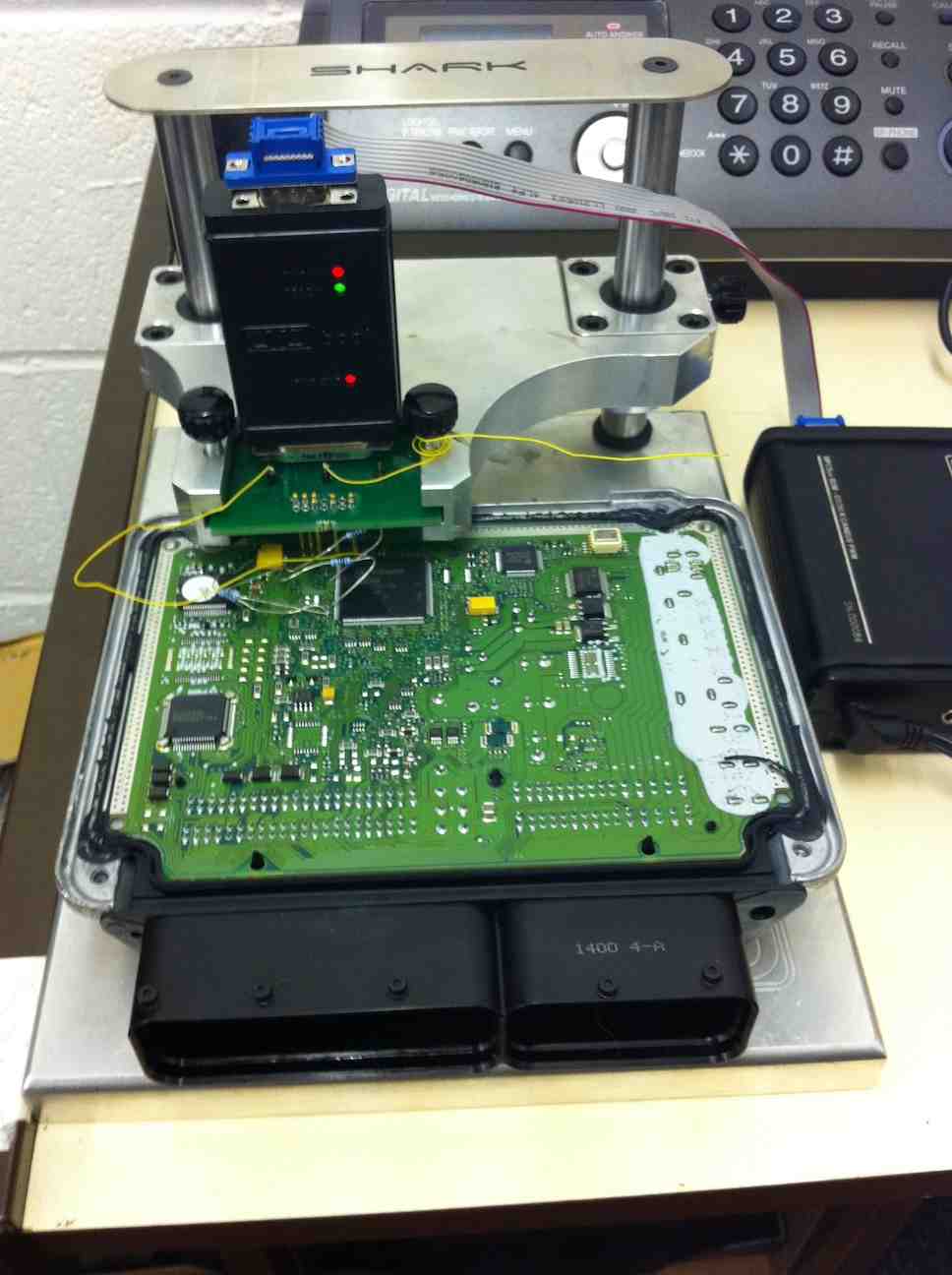

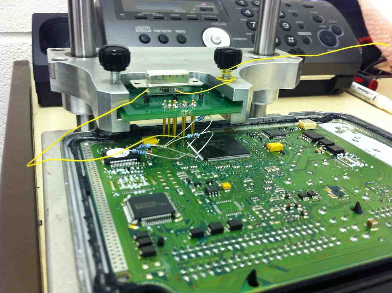

AS I write this, Ben is soldering some wire and resistors to my ECU. Talk about scary!

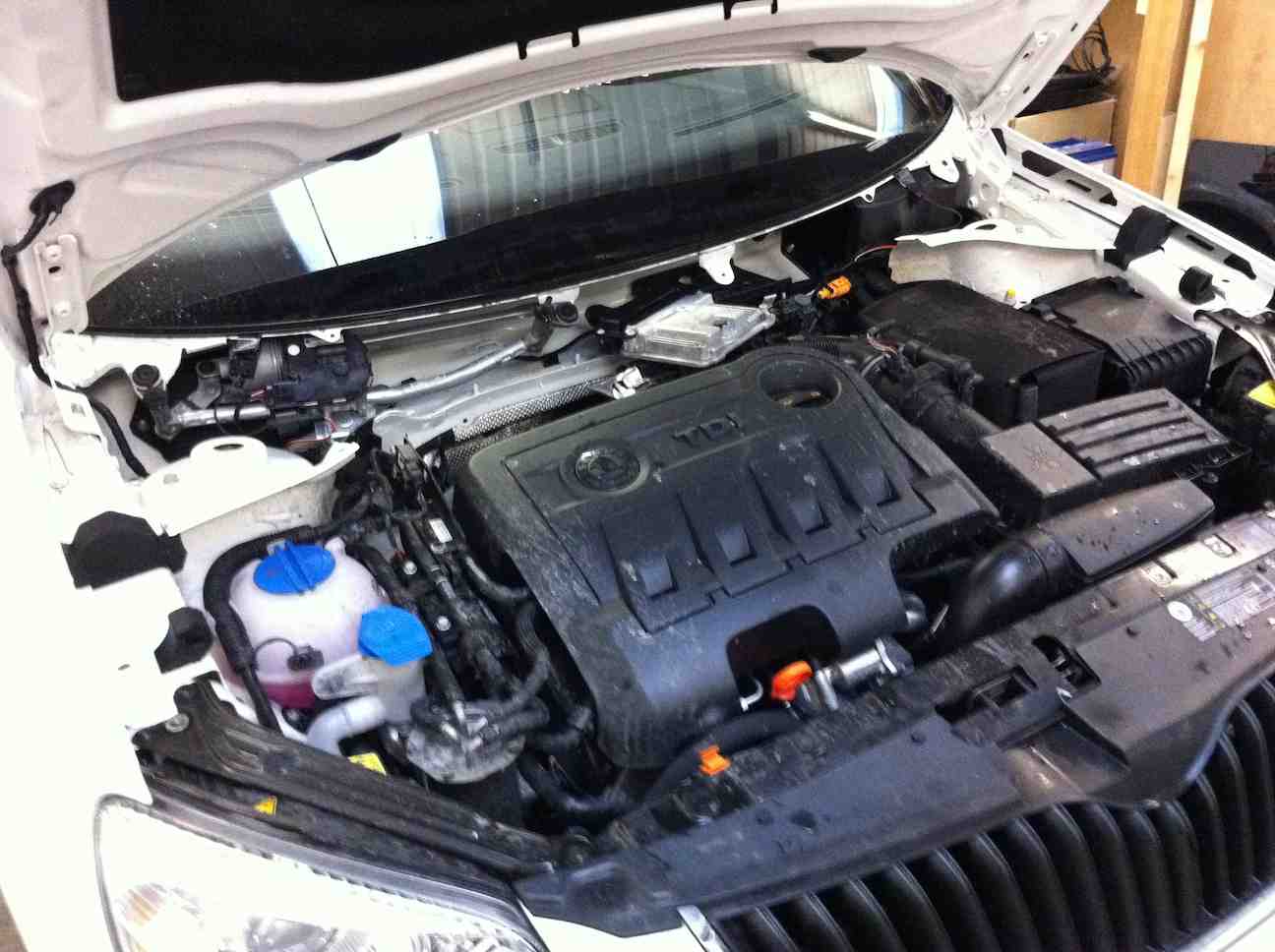

First of all he dismantled the area in front of the windscreen.
Then he used a grinder to put a flat head in the security bolts so he could remove it from the car.
Then he had to heat up the casing to soften the seal so that he could get into the circuit board.
We won't know if he can remap it until he has soldered the wires and required resistors onto the board and hooked it up to the laptop.

We have been able to read the ECU......
Some more photos:

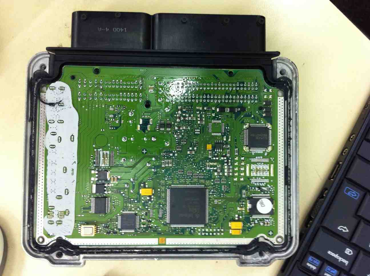

open heart surgery finished:

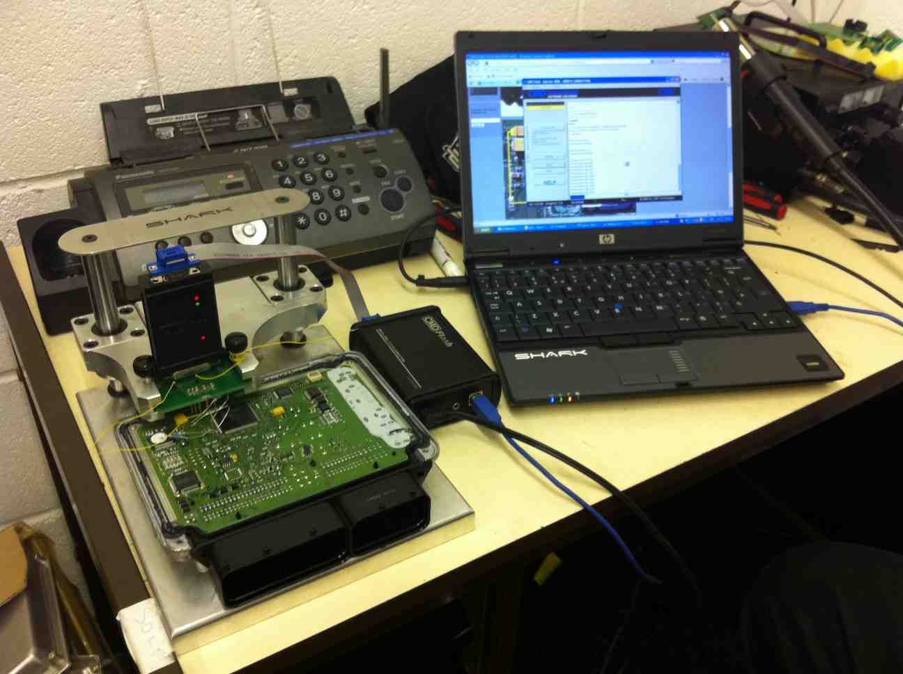

Connected to laptop
The laptop doing its stuff

The remap is now written and installed.
