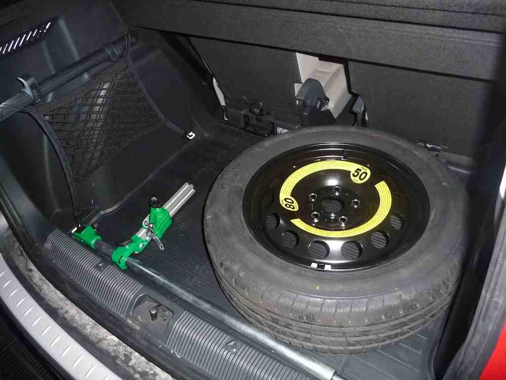

I bought Elsie with a spare wheel. Done deal really at £55. But I also wanted to carry my bicycle inside the car. So I bought all the extras needed. I have now just had a play.....

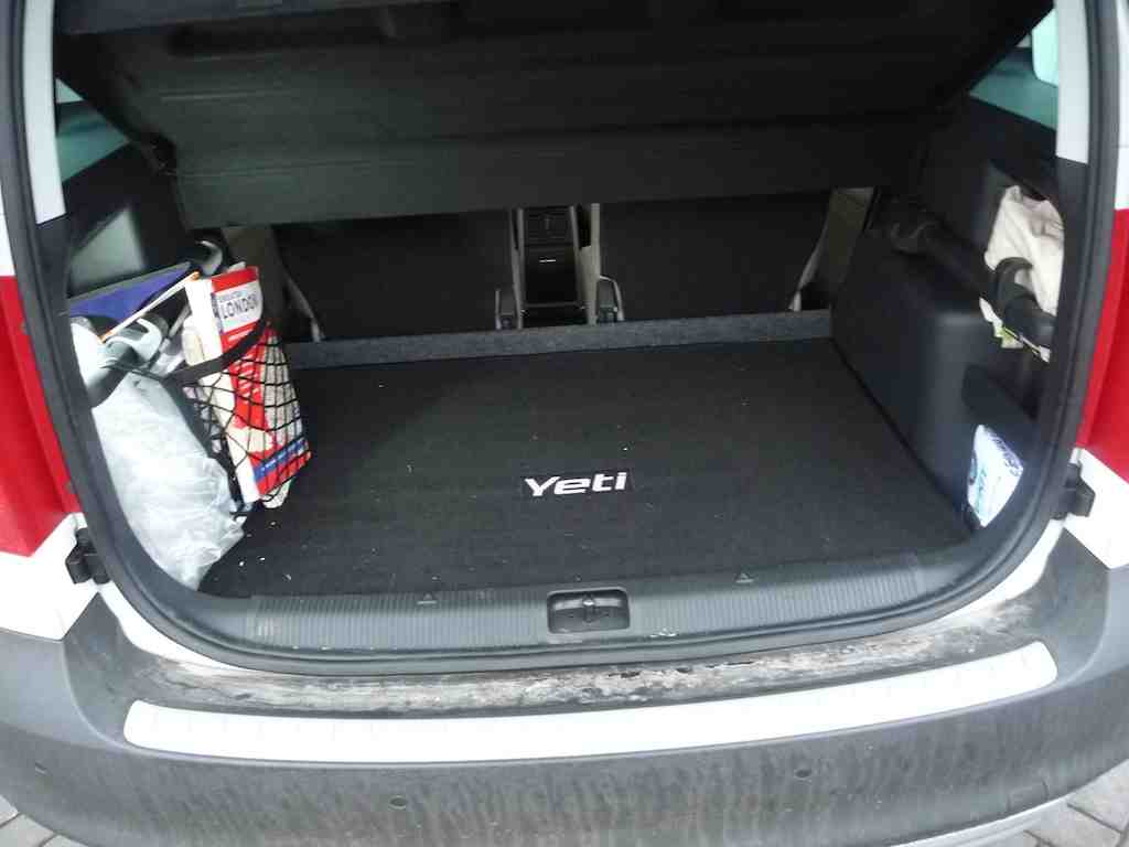

Elsie as supplied:

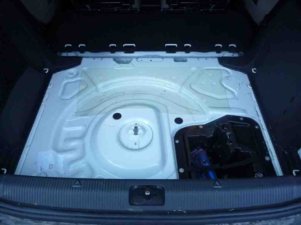

Elsie with all spare wheel bits removed (need a torx driver):
Elsie with Polystyrene filler placed in boot:

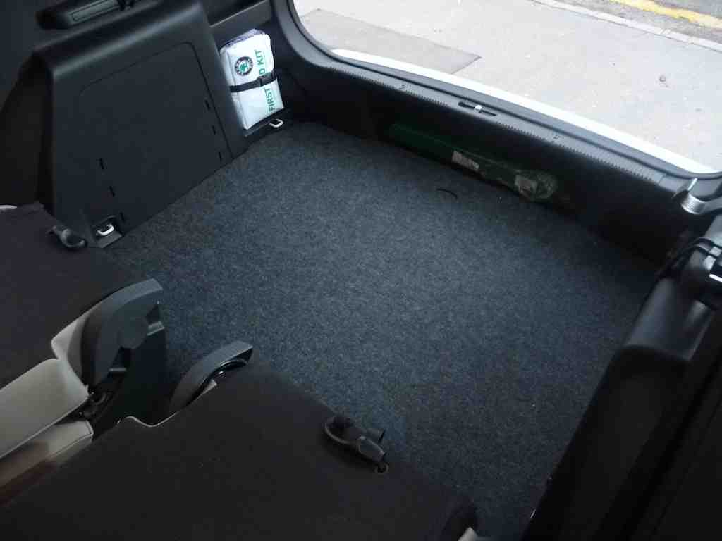

Boot floor fitted, with first aid kit and warning triangle:

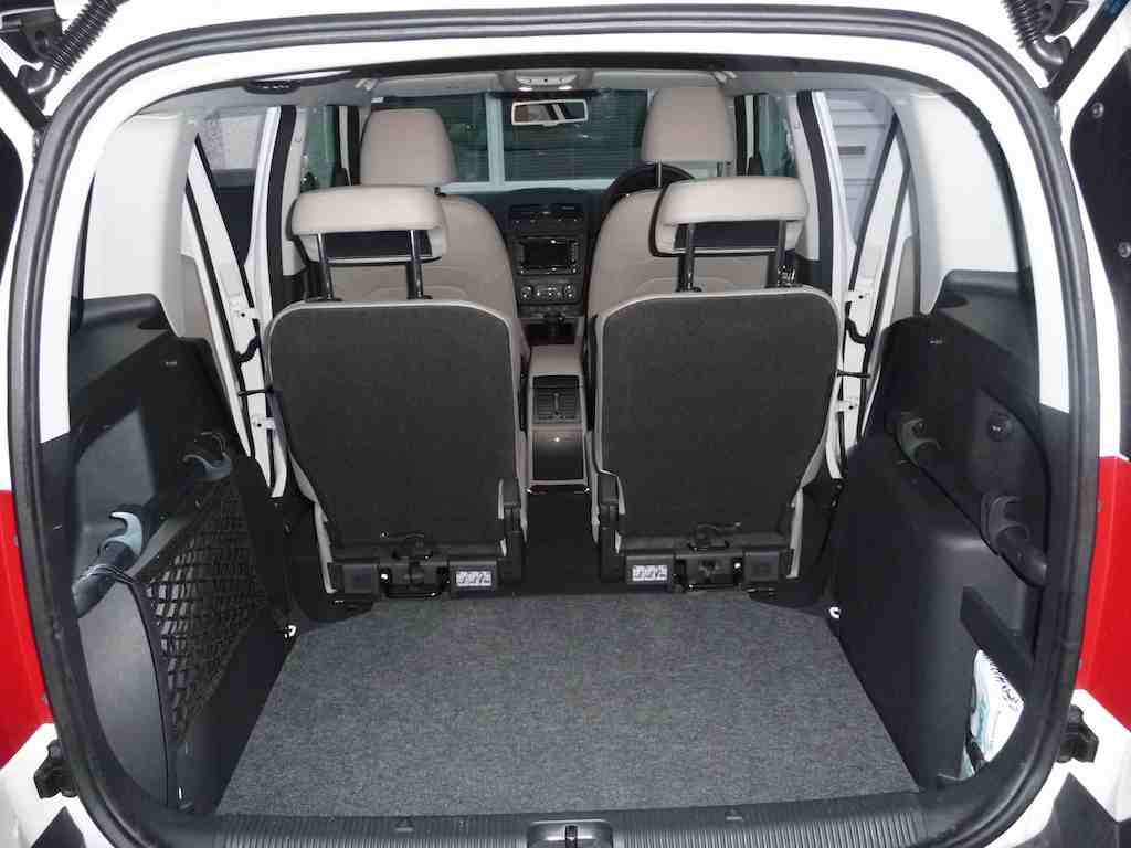

Rear view of boot (and 2 seats):

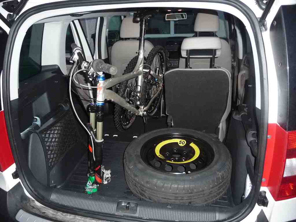

My bike mounted to the internal bike carrier, spare wheel and 1 rear seat in situ - in the "centre" position:
Spare wheel, Internal bike carrier and rubber mat:
So, when you are told by Skoda that you can't have both, that is a lie.....you just can't have the false floor etc, and the spare wheel is not covered. All of a sudden I have so much more room in the boot.emoticon-0100-smile.gif It all fits nicely.

Like it... Just that that carrier is VERY pricey... And I usually carry two bikes or more. But I do like it. How much was the Polystyrene filler and the lower carpet? I like the idea of the more room...

The polystyrene filler was about £26 and the boot floor, which has sound insulation on the bottom and carpet on top of the hardboard, with lots of spacers and cut outs, was around £55.
I picked the carrier up via ebay, from a forum member for about £60, which is what they had paid for it.

Neat solution - would recommend doing the reat seatbelt up when in motion, if the spare is "loose".
I always do all rear seatbelts up if I have something (e.g. suitcase) in the boot.
Sorry to pour cold water on the cunning plan, but you now have an unrestrained decapitation device sitting in the boot.
You really do need to restrain the spare wheel somehow, as in a collision it can become a lethal object, even with the adjacent seat in the raised position.
Skoda do not offer the bike kit for cars with spare wheel because of the rist of litigation should someone be injured by a loose spare wheel.

That spare may be loose, but on the rubber mat will not move anywhere.....

Skoda don't offer the internal bike rack with the spare wheel because it won't fit. emoticon-0140-rofl.gif It fastens to the U clips at boot floor level, where the net program connects to.
I think your solution is great in theory... it's a shame that Skoda dont make an adaptor to mount the spare vertically in the boot!
Great idea. They do.
The bar which the hangers clip on to would be ideal. Just strap it to one side. Just can't use the boot cover. Doh!
In the mean time I will continue to use another net or straps to restrain the wheel.
Rubber mat will stop things sliding, however in a crash you may have a wheel on the loose in the cabin.

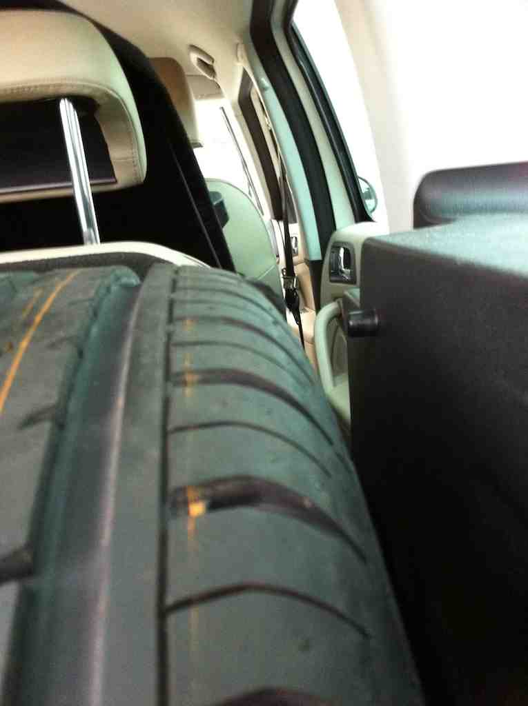

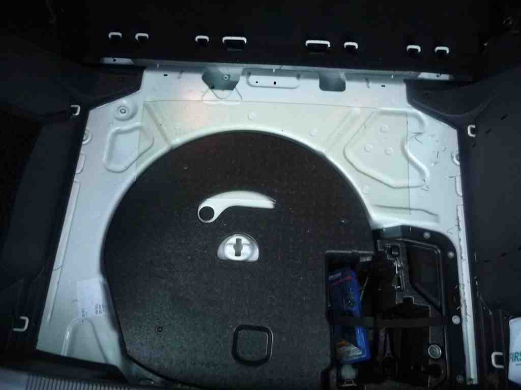

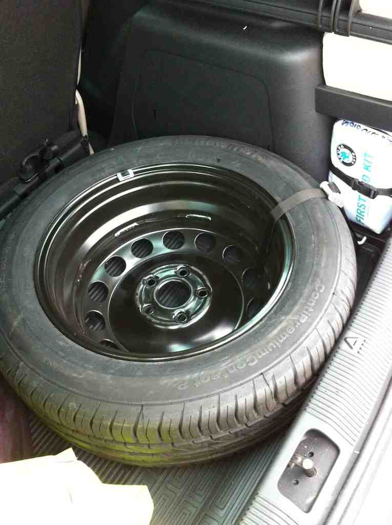

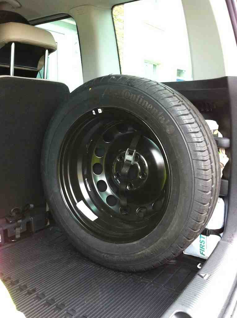

I have done some playing after washing Elsie today
Here is the spare wheel in boot standing up: (secured to the railemoticon-0136-giggle.gif)
You can't fit the cover as the wheel is too tall unfortunately - see locating peg:
and in the lying down state, upside down (for Johann) secured:
edit: The wheel can go either side.

I many ways I prefer the upright position, If I could find a way of covering the boot. But saying that, it does have sunset glass, so people can't peek too much...
