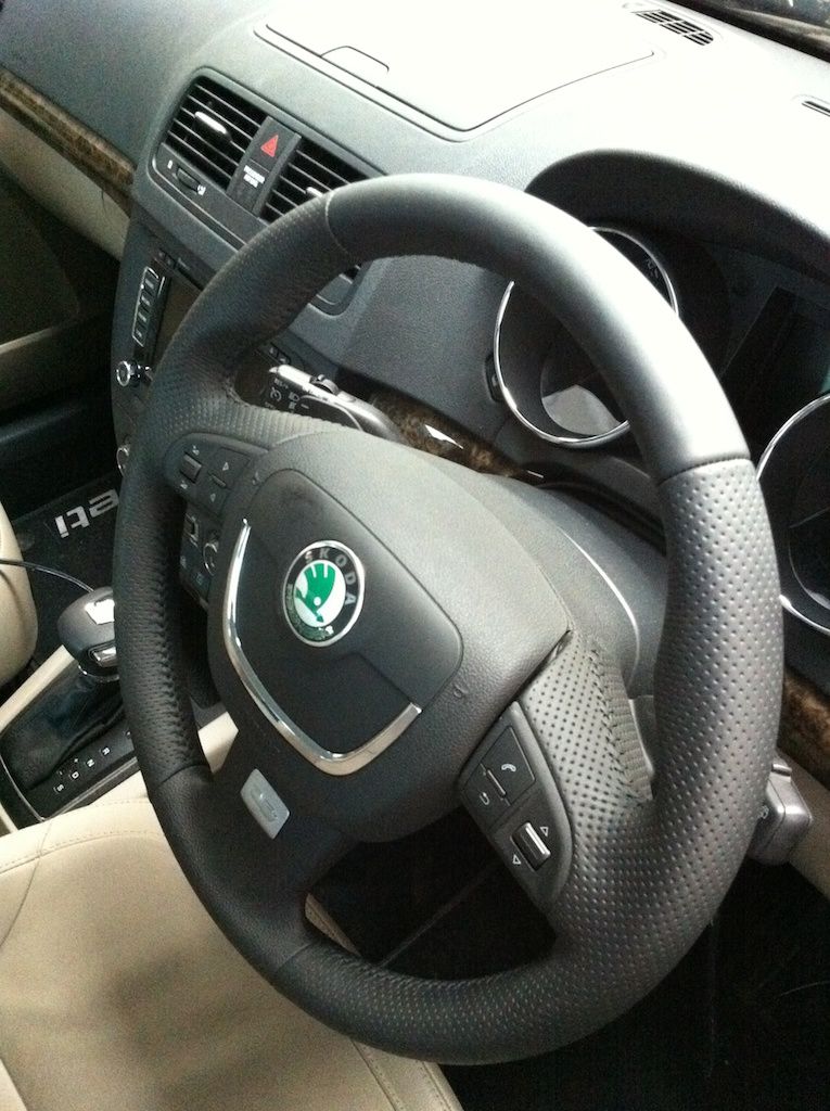

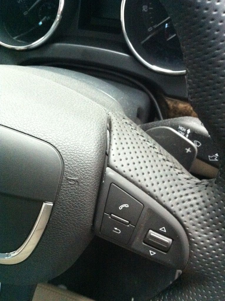

Look what Ben has just fitted
So basically one could fit all VAG steeringwheels with paddles ?

Hi...I'm Italian and yesterday I installed, with my wife's father, steering wheel with 3 spokes and dsg paddle (Octavia RS's model) on my Yeti 1.2 Tsi Dsg. I bought this NEW and PERFECT steering wheel one week ago, on internet from SKODATEILE site: only 156€( and 32€ shipping)!!! 30 minutes on work and 15 minutes for coding with Vag cable and VCDS program.
So there are now 2 Yeti out there with flappy paddles......
