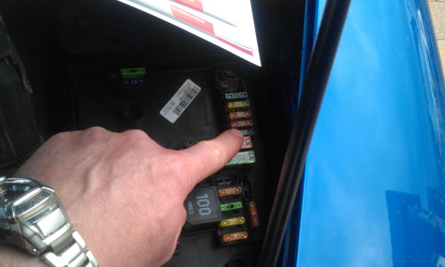

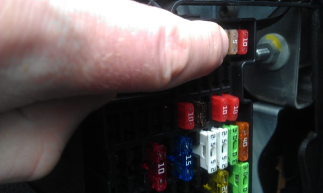

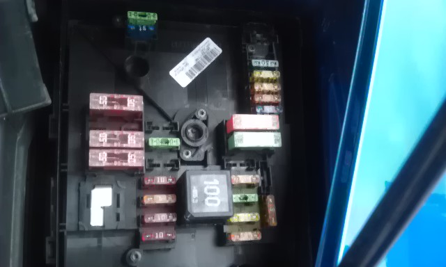

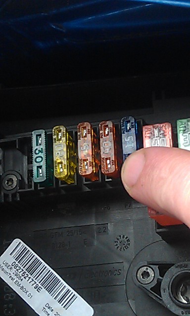

Hi guys
I have taken some pics of the fuses you need to remove from the fuse panel on the drivers side and the one beside the air filter under the bonnet, unfortunatly I cant post them as I'm not a freedom member, but I can send them to skodaphile for him to post here.
Once removed the car will run smoothly on the dyno :)
PM sent to skodaphile
Cheers
I've been in contact with jcdub, a member on here who has had a CR on a dyno and had to remove two fuses-I've asked him to post up the info, so hopefully he'll be on soon! :thumbup:
OK Pick taken and they will be posted shortly through skodaphile as I'm not a freedom member :(
Anyway thae both of the fuses out shown in the pics and you should get a smooth run on the dyno.

as taken by jcdub
