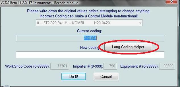

No it is not correct, yes it can be changed, I did 900000's Yeti and have done my Superb as well
You need VCDS to do the following:
To change the country go to 17- Instruments and click on "Coding - 07"
Then click on "Long Coding Helper"
Finally under Bit 4 select "70 Country: Australia (AUS)"
Return to previous screen where you will see that the long coding has changed, click on "Do it!" all will then be saved.
HTH
