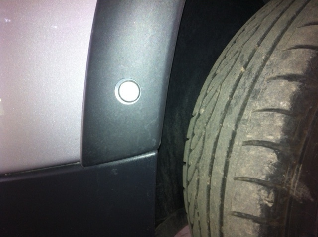

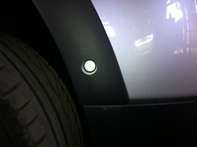

I suspect the hole you need to "drill" into the flares will have to be too big so that it is invisible to the parking measuring eye. That eye is NOT a parking distance sensor AFAIK but only functions to measure the parking space for the Park Assist. So if you cut a hole that is not big enough this eye will constantly "see" the flare and mess up the PA system... Cutting a bigger hole will mean there is little flare left - hence the flares are not PA compatible. Everyone always says "just make a hole for it" but I've yet to come across a single person that have actually done it.

I stand corrected then. :rofl: And I imagine your PA still works? Any photos of how big this cut hole is?
Park assist works perfectly.
Next time i go to my Yeti Ill post a pic on this thread.A bit later today. Hole drilled exact diameter of eye,possibly a small fraction larger,well see in the pic.

I went out and took these:The drilled hole diameter is a couple of mm larger than the eye.
Edited by oriki
Thank you! Proof is in the pudding and now I believe it is possible. :giggle:
I forgot however that the eye will be body colour! LOL So you need to get two eyes from a BLACK Yeti! :giggle:
How did you "drill" the holes if I may ask?
I have a friend who works with metals and he has a large standing drill in his workshop with drilling bits of all sizes.It took him a few minutes to drill the two front flares (Before being stuck on the bodywork,of course!)
I think it could be done by heating a piece of round piping and burning through the plastic,which is not very thick.
As for the colour of the eyes....not much can be done but it does not show unless one kneels down and checks.
