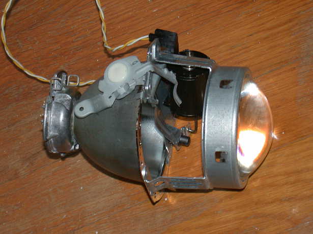

It moves a small shield inside the projector unit.
The shield is handed so UK RHD lamps have a shield on the opposite side to the Euro LHD.

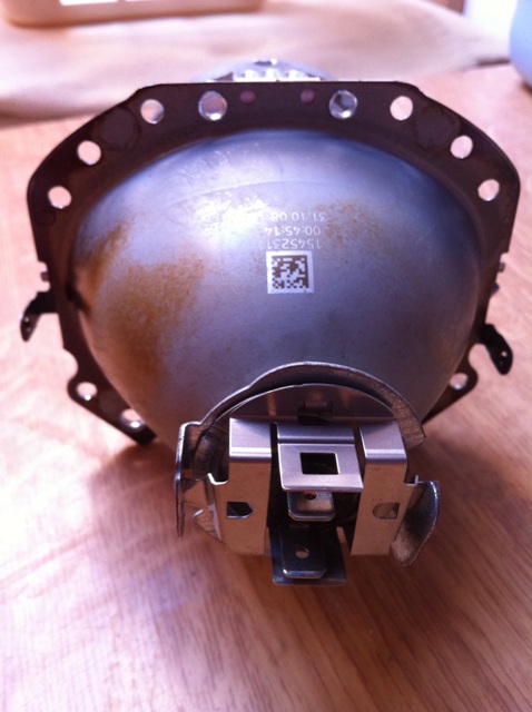

I actually tried to instal the bi-xenon projectors but Hella place the shield motor in a really tricky location that interfers with the projector mounting frame!
