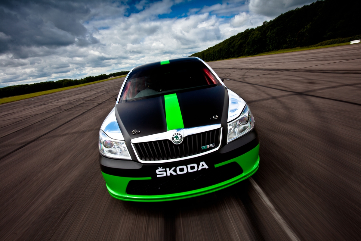

I think that paintjob just made me do something in my pants :o
:thumbup:
Few more piccies courtesy of EVO.CO.UK
:thumbup: :yes:
That thing looks awesome! Any planned power upgrades for the road car now then?!?!?! The 267bhp that Audi VW and Seat get is just not fair............

Well I want that paint job, but if I were to put it on the road, it could not have just a normal set up ;)
