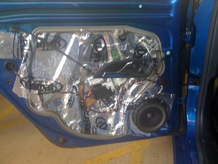

Here are a few photos I took during my ICE install earlier this year. Possibly a few useful pointers in here for people, like the location of the grommet for running the power cable in from the bay. Me and Dan did this in a few hours in a community center car park and the under cover car park at Morrisons when it started raining. All in all quite a fun job.
Note the rain guard behind the speaker
I subsequently cut those studs right down with a hacksaw for side impact crash safety
I've included this embarrassing picture as an illustration of what not to do. Unless you enjoy picking dynamat out of your window mech. I didn't enjoy it.
Dan doing something electrical.
Nice! I like where you've mounted the amp, whats with the big 'door' on the side of the boot lining though, I don't have that on my car?

Thanks very much for those pictures, thats answered all my questions :thumbup:

Yup, Pioneer TS-A171Cis - the tweeters are where the original OEM tweeters were. Fit perfectly.
