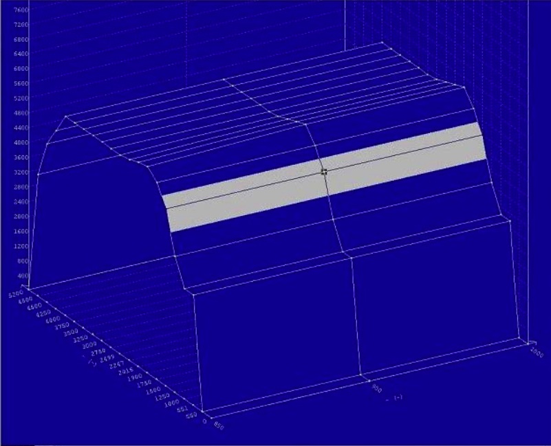

I have attached winols torque limit pint screen
I'll sort some screen shots tonight.

drivers wish
Torque limiter
Smoke limiter via MAF
Which ever one of these gives the lowest value result in that value being used.
Eg. Dw-70, tl-55, sp-60 = 55mg being injected.
