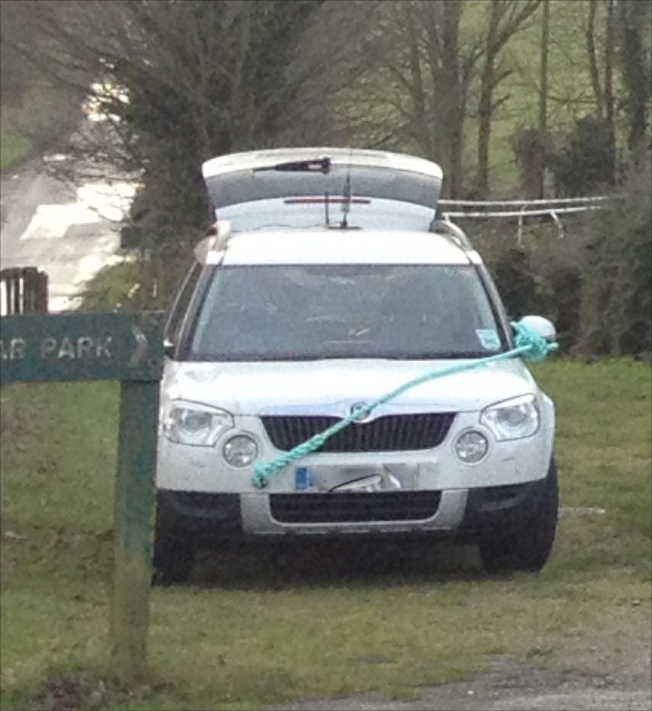

I did fit my towbar and the tow eye had a rope fitted to it just in case I got stuck and needed a tow. Wrapped end round passenger door mirror.

Here is a photo of Elsie almost ready to go, complete with rope looped around the towing eye and also around the wing mirror. There is also a CB aerial on the roof, with the radio in the car.
