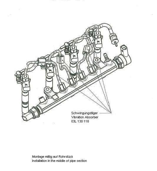

I have found a bit more information on this, which might be helpful:
The nature of the problem is a certain supplier's fuel lines which have scoring marks made during manufacture. When this is coupled with the pipes vibrating during certain operating conditions of DPF regeneration, cracks can be formed which lead to the fuel escaping. Not all Diesels are affected as the fuel line supplier source has been replaced.
When the work is done, you will find under the engine cover, some additional rubber blocks which are anti-vibration balance weight items to change the resonance of the pipe work that crosses over the top of the engine (4 pipes) plus a bit of nylon over braid over a pipe near the throttle body. The pipework over the top of the engine is the pipes (4 off) from the common rail unit on the front top of the engine to the injectors at the back. Picture attached.
The work will take around an hour to complete, and the car gets the usual small sticker with the Skoda campaign number recorded on it (23K5); also the Service Schedule Logbook should have an entry in the back pages under Workshop Comments.
Those affected by this recall should be notified in writing from a Skoda source.
