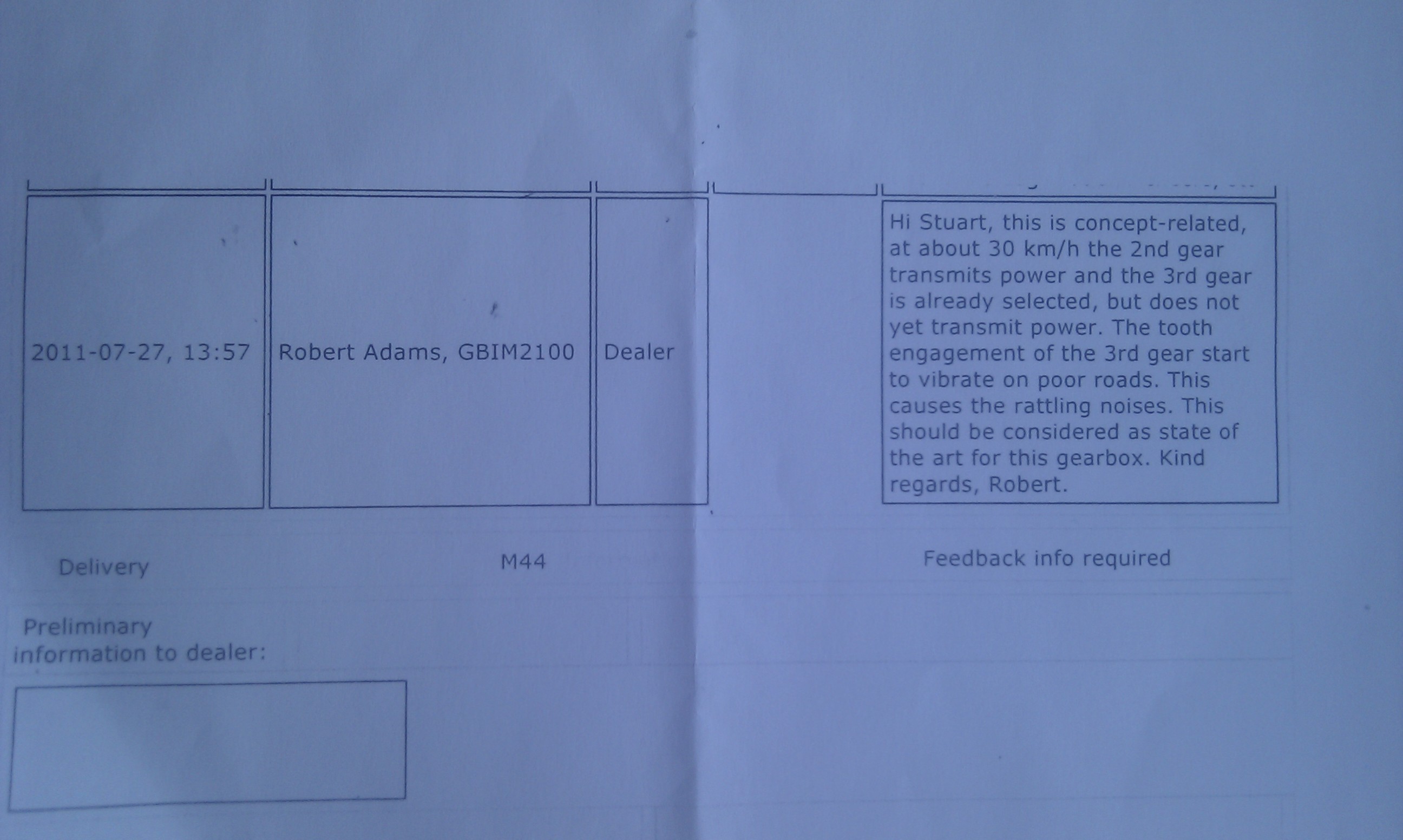

agreed therattle is supposed to be a characteristic, has been done to death on seat forums, and has been explained as above. (dirty hari) but to be fair, I can never hear any rattles on mine...

My shocks or something in the rear started squeaking but put this down to the weather and gave it a good jet wash to clean out any crap from salt etc - all fine now. Only DSG noise is on bad roads in 1st and 2nd and most others have this fault as well as VW saying its a characteristic of the box.

It is a quirk of the box. Roads in Swansea are rubbish so I do hear it now and again in lower gears at slow speeds. Still works fine and it's done it from day one. Creaking rear suspension I did have briefly when it was cold but that's gone now too.
