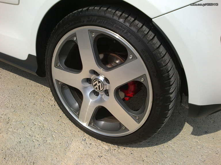

Hi i have the fabia mk1 1.4 16v at 16''s spiders.they wear 205/45/16.
I need to change to 17''s. i found vw's ''santa monica''
they wear 205/40/17.
I see to a tyre size calculator that the correct tyres are 205/50/17 or 215/45/17.
Why the 205/40/17 are most wearable?

Its because they are a bit cheaper and closest to the rolling diameter. Thread solved
