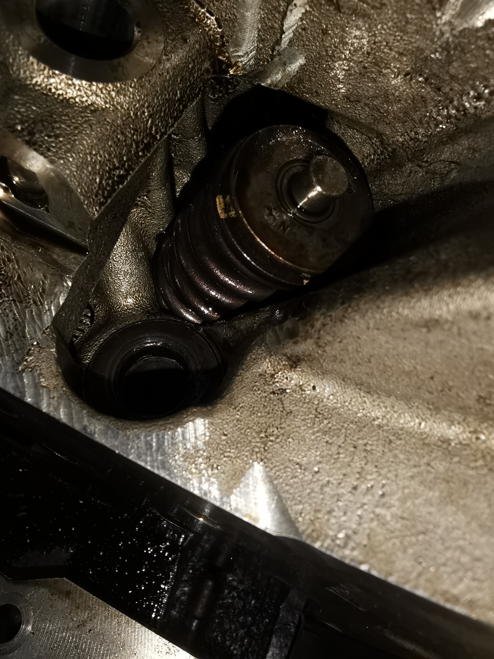

On 14/09/2020 at 08:23, rayx said:
They are bad folks ... Wrong sparks used, Bosch FR7ldc+ (NGK BKR6EK) instead of Bosch F5KPP332SBN (NGK PFR7S8EG) ...
According this photo loss of compression happened on cylinder 2 and not 4 as they said ... Are you sure the engine did not drink oil over the alloved limit?
Melted exhaust valve on cyl2 says something different, oil thirsty beast ...
"Oil consumption wasn't too bad ,around a litre for a thousand miles" says everything,
a bit over or just on the limit (up to 0,5 litre for 624 miles/1000km) for long time does what it has done.
That picture is from before the 1st repair, so far no one has honoured their warranty on any of the repairs...

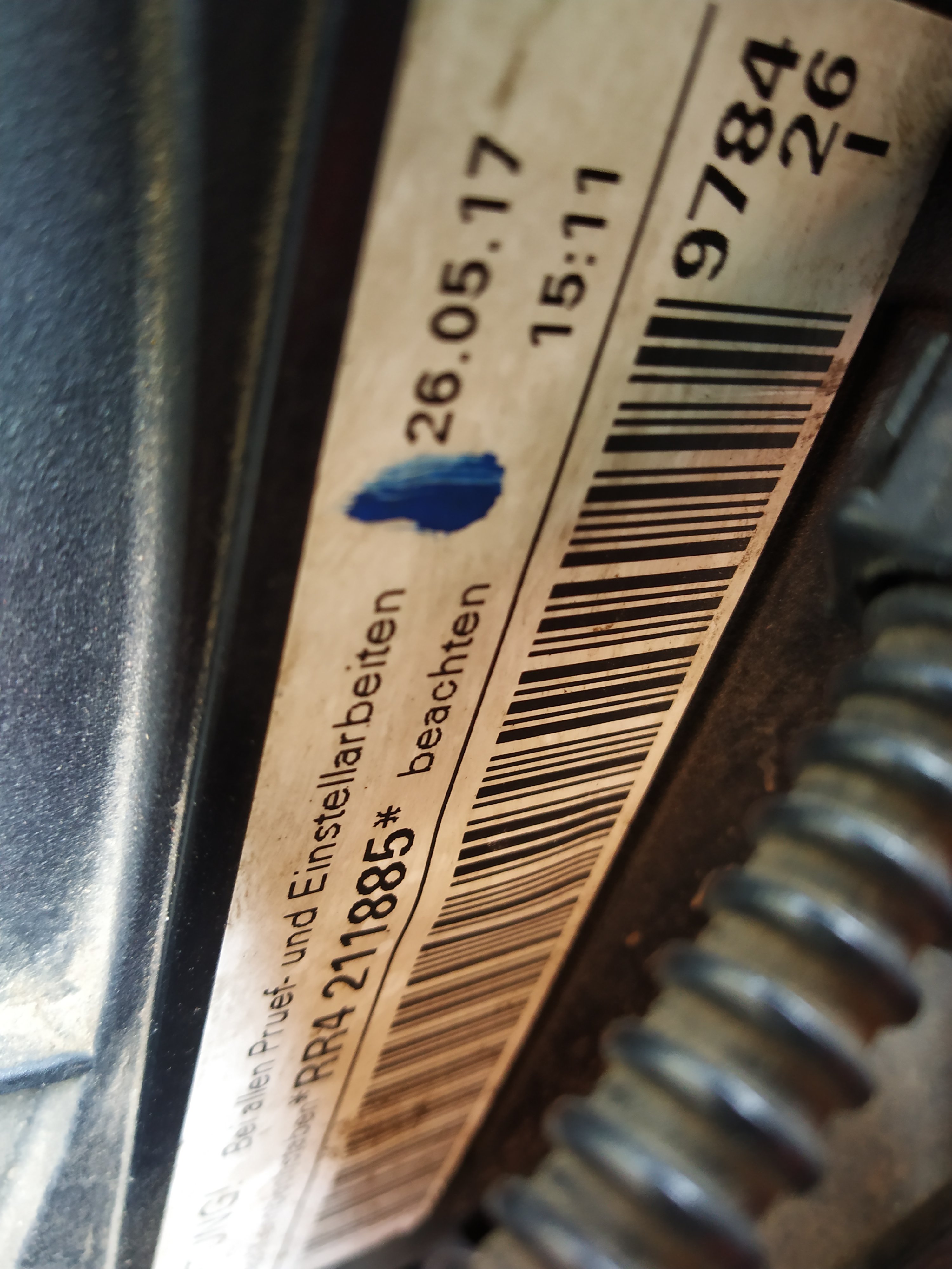

SuperRaj - Better chance of finding this information if you can supply the engine code and production date, which is normally encoded in the vehicle documentation and a sticker on the timing chain cover.  From this you  can work out when the base engine was actually made - production year and week - Not the date it was fitted.  It may have been in storage for a long time before fitting.  Best if you can post up a photo from the engine, then the more clever experts who visit here may be able to better advise.
This is the Engine serial number written on the replaced engine.(Image)
And the original one had engine serial number:-CDA272192
  • 2 months later...
Should be ok based on that 2017 production date. I don't have access to the serial numbers to check component build of the base engine.
