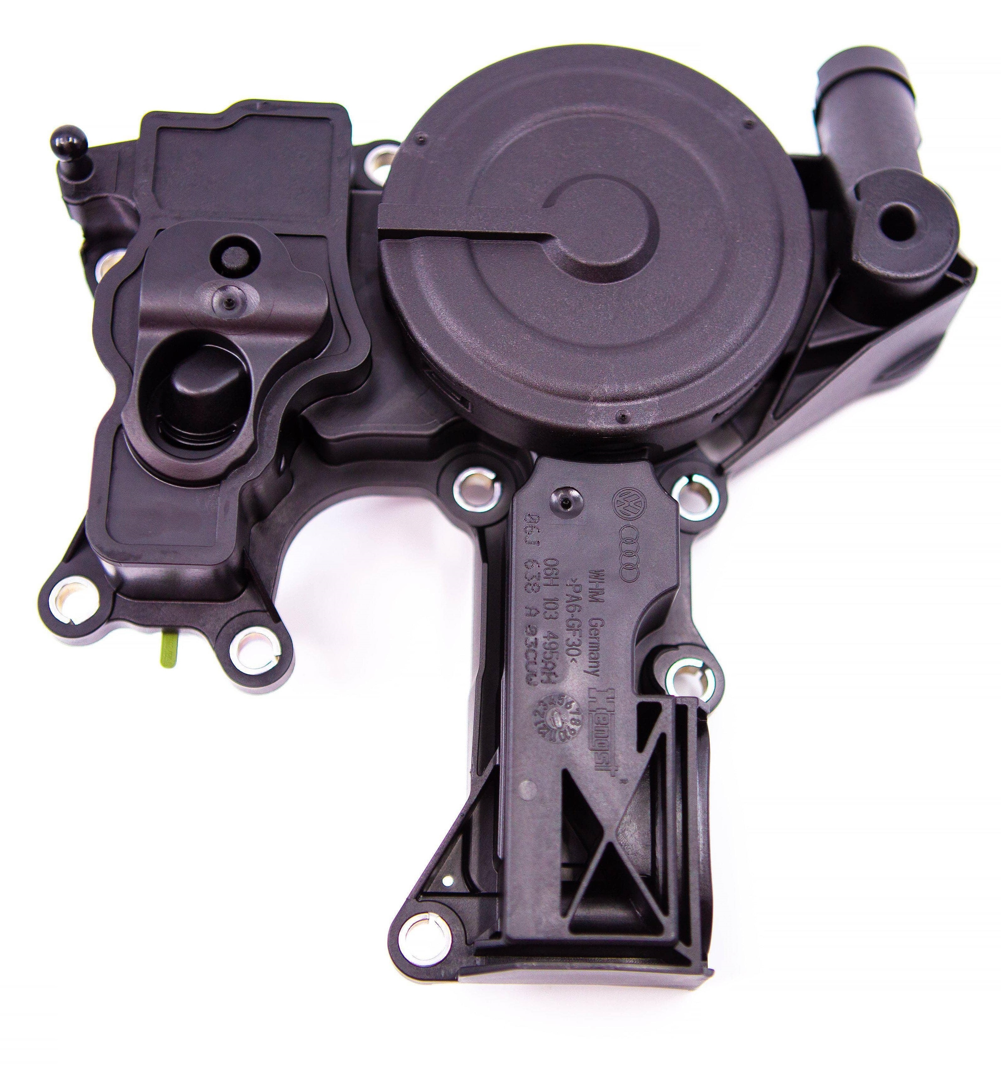

Wife has a  ( 2012 ) Octavia-II with EA888-II TSI  engine.
The car works incredibly well, but drinks a lot of oil.
( I only put 100% fully synthetic oil 5w-40 in it. )
Was thinking of changing the PCV-valve to see if it gets a little better,
but it comes in 2 different versions that are apparently not interchangeable.
The latest version of the PCV-valve are apparently available in 2 different models from VAG-dealers with 2 different part numbers.
Even my SKODA dealer didn't know the difference and which one I should have
🤔 Anyone here know what physically separates the 2 different PCV-valves for this engine ? 🤔
🤔 Anything else that is good to replace at the same time as replacing the PCV-valve ? 🤔
06H 103 495 AH
#  06H 103 495 AJ

Hello 2stroke, I can't answer your question directly but my understanding is that the same part number, with only a change to the suffix letter indicates a revised part - so either part should fit.
06H 103 495 AH
#  06H 103 495 AJ
Yes. All true. Very much not understood by VW parts departments, TPS, mechanics but there were 2 different designs and they were applicable to different manufacturing periods. I'll have to look up my notes for @rayx and get back to you what you need. But I remember enough to know / recall that AJ and AH are on different streams i.e. not appropriate for vehicles that build across the specified date... But, again, if you've got serious oil usage it is likely to be oil scraper rings design fouling,  that has caused bore scoring... a very very common problem in gen 2 especially 1.8tsi
