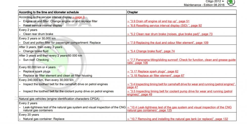

This is the reply I Got from Skoda UK in regards to both the cam and water pump belts change period
'I am happy to confirm that the information I previously provided is correct, and to confirm, the cambelt replacement intervals
for your vehicle are 160,000 miles'
'Having your cambelt replaced every 4 years is a UK recommendation on most Skoda vehicles, but Skoda UK's Technical Department maintain that every 160,000 miles is the interval for a cambelt replacement on your Citigo based on the engine type and size'
