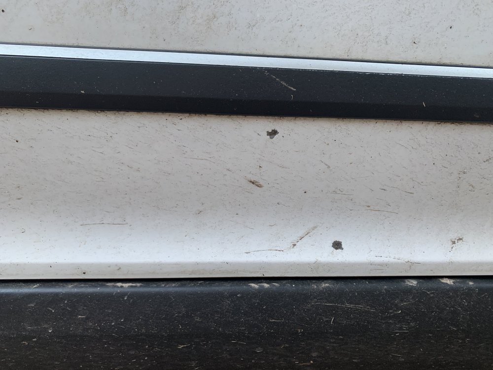

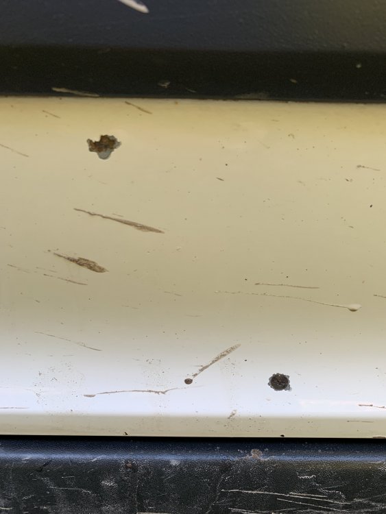

Any one else getting blisters on doors?
They are definitely not stone chips, I have stone chips on the bonnet, front wings, windscreen etc, but these are blisters or bubbles that seem to form under the paint first and then form a head.
I have them on all 4 doors, above and below the side protector strip. No where else on the car.
The yeti is 15 month old and the body work was perfect as it should be when I bought it new. The blisters seem to have started in the last 6 months. They are all sizes and quite difficult to see on the Cappuccino Beige unless it has just been cleaned.
The colour was chosen as it hides the dirt well, the yeti is my works vehicle and it is used every day and only gets a hose off between jobs. It has done 32,000 miles. My last two works vehicles (Honda and Nissan) never had any thing like this, and I’ve never seen or heard of anything like it before.
Dealer is going to have a look at it.

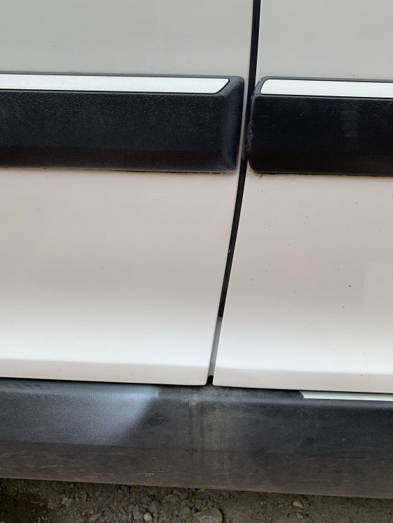

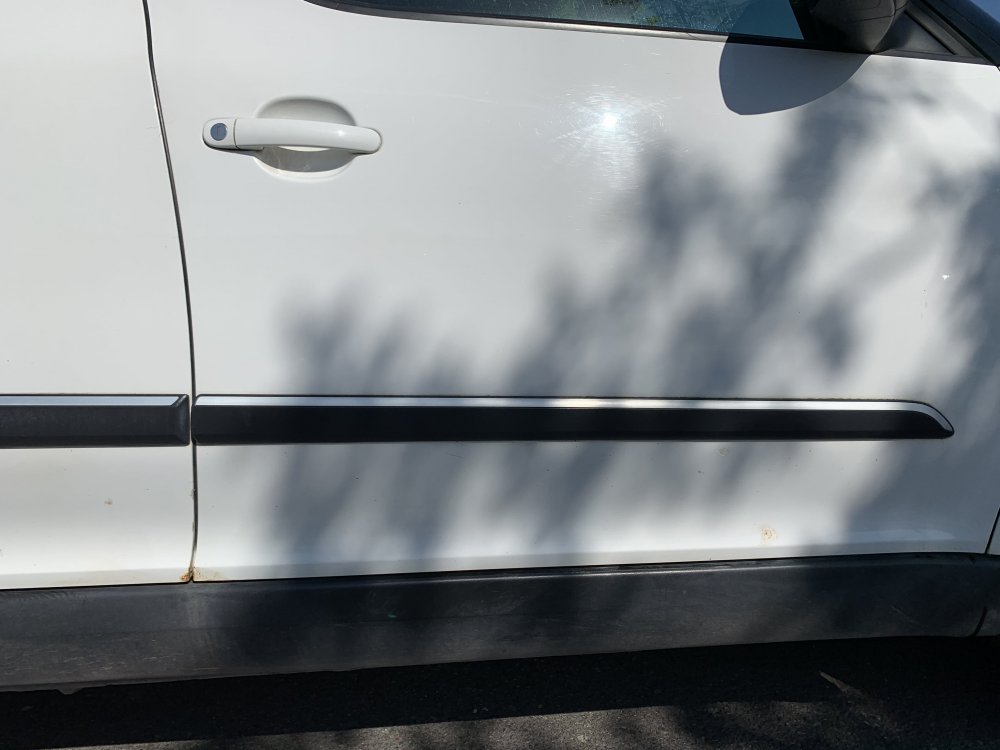

I have paint blisters on the front doors now. Each has a tiny pin-***** in the centre and spreading corrosion under the paint. Just like the back doors before they were resprayed.
Dealer says they are stone chips, which are not covered by the warranty. However, there is a technical bulletin about paint being rubbed off the trailing edge of the front doors due to body flex wearing the paint away where it is in contact with the rubber seal between the doors. The lower rear corner of the drivers door is through to bare metal where it is in contact with the seal and is now rusting. Photos have been taken and sent to Skoda to see if they will respray it under warranty.
