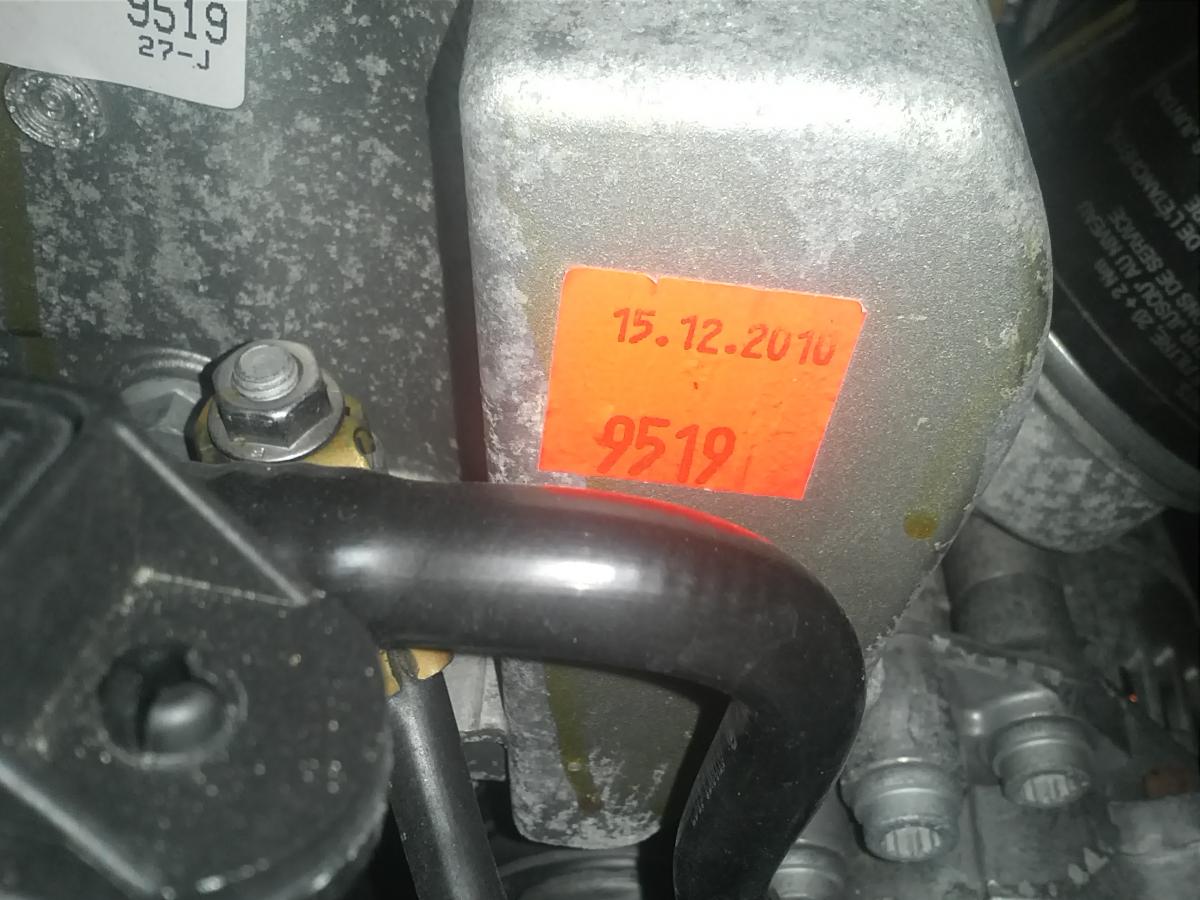

?Is it a 2010 build but not First Registered untill June 2011?
Check the orange sticker on the Cover at the drivers side of the engine, it will give an idea of the Build Date of the Engine.
Hopefully you have a good one.

Is it showing the Date on the Orange Sticker.
(15.6.2010 & the ECU's Code Number on my Orange Sticker posted below. I think its the ECU Code) EDITED>
It matches the Bar Code to the Left of that & the Number on the Barcode matches the ECU on the car.

Oh ok.. I get it.. My little orange stick is showing 15.12.2010, it has had a ECU and DSG upgrade before it was delivered to me.. I demanded one from them... So is mine a late 2010 model not one of the early ones then.. its still a CAVE engine though...
