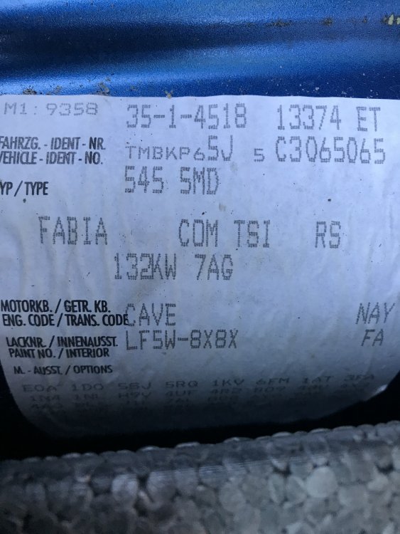

Hi, is there a simple way to ensure what engine is actually used in a car? I'm looking to buy one and want the revised one. Is there a change in engine cover or is it simply find and check the engine or chassis codes? Thanks Matt
It will have left the factory from April 2010 til about August / September 2012 with a CAVE engine and a sticker at the bottom of the drivers side B pillar with CAVE on it.  That does not mean it will still have a CAVE engine or the 2nd engine still in it. (VIN Sticker in the Boot as well says CAVE.)
Late 2012 a CTHE will have CTHE on the Stickers and no guarantee that original engine is still in the car.
No guarantee the original parts are in the engine, or the original ECU.
Looking under the bonnet will not tell you what engine is in.
If there is a little orange sticker at the left side of the engine it might have a date on it showing when it was made, but that might be correct or not.
Does this sticker not have engine code written on it?
Can't zoom in enough on this one to see, but it looks like the sort of sticker where I'd expect to see it on.
^^^ That is how they are in new cars, and how replacement engines did come.  Well some Replacement engines had the Stick on Barcodes etc.
Some do not though. So just the Block Castings and the ground of marks.   There are threads on here on the DVLA & Skoda / VW and Engine Numbers and records..

Worth a look then, but not guaranteed to be present or correct.
Yes worth a look.
You might then know what engine the car presently has.
The Engine it left the factory with is on the Sticker on the drivers door pillar if still there, or the Build Sticker in the Spare Tyre Well.
Some cars are on 2nd or 3rd engines, some are rebuilt and some got short units and some base units.
Sometimes the ECU helps with knowing what engine the car has. Some replaced engines need a new ECU as it changed early and later CAVE, & Early and later CTHE,
different locked ECU's in the CAVE, then the CTHE.
and various maps over the production run and with the breather mod part 1 & 2 and the Oil Spray Jet upgrade.
