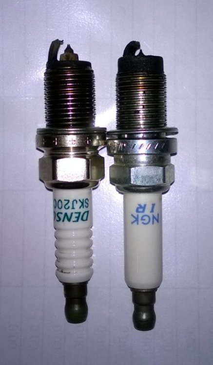

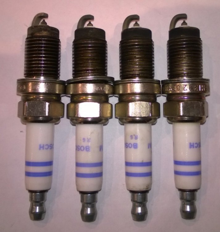

Bosch plugs worked a treat after problems with Denso's IR's so on a mapped car for me the Bosch i would highly rate.. condition of all 4 below approx 6 months.
NGK IR and Denso IR have both had problems (see 2nd pic)
I am now testing Laser Platinums NGK but has Offski has kindly noted that they are the same part no. as the ones that failed 2009-13.
Maybe its the Iridium coating that is problem for me or bad luck on plugs....
Will report back if any issues with the Platinum NGK's,
Least i know the Bosch are good, only took them out cos was service and already ordered the new ones, any probs and the Bosch are going back in!

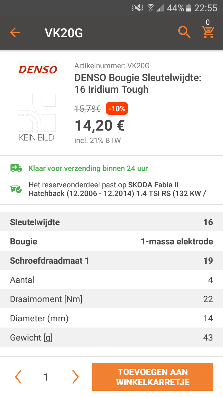

What Bosch plugs you use? How much? I'm about to buy some new plugs and I was considering the iridium tough densos. What problems did you have with them
He did not have the DENSO tough which are the VK20 that Euro Car Parts and others have, it was the SKJ's which are usually good in a Twincharger but he had one go the same as the Standard NGK or the later from 2012 on NGK go on one cylinder.
The Bosch condition does look good in the pic after 6 months and a Remap,
i am interested in how many miles they did in the 6 months though.
A Remap to stage 1 when it is a good remap as it seems that Kobayashi has had done does do wonders for a CAVE engine and its not always about more power but helping the fueling to all 4 cylinders & an engines longevity.

Bosch code = FR6HI332, tuning shop put them in after the Denso tip broke off after car was mapped, not sure how much they cost.
A note on the random denso failure they were supposed to go in after the oil fixes at skoda but SKODA forgot to do it, they couldnt even find them when i went to collect, as i asked for the old plugs, Anyway i think they got handling damage as they eventually located them in a cupboard they had been out of the boxes.
So i took Denso to tuning shop a month later, they looked ok, but who knows someone at skoda could have dropped them or something?
Approx 4500 miles on the Bosch which i know isnt a lot, all short journeys, oil not warm (most of the time) and some very fast boosting at times. :tongueout:
Car has had a hard life but still on original engine with good compression,  and as mentioned on my project page could not have got this far without this forum and studying all the posts / topics. (george you know my car well now...)
I think the Denso failure will go down as a mystery. The tuning shop i use doesnt like Iridium plugs by anyone. The bosch used is a Double Platinum, so maybe Double Platinums are best for me too.
