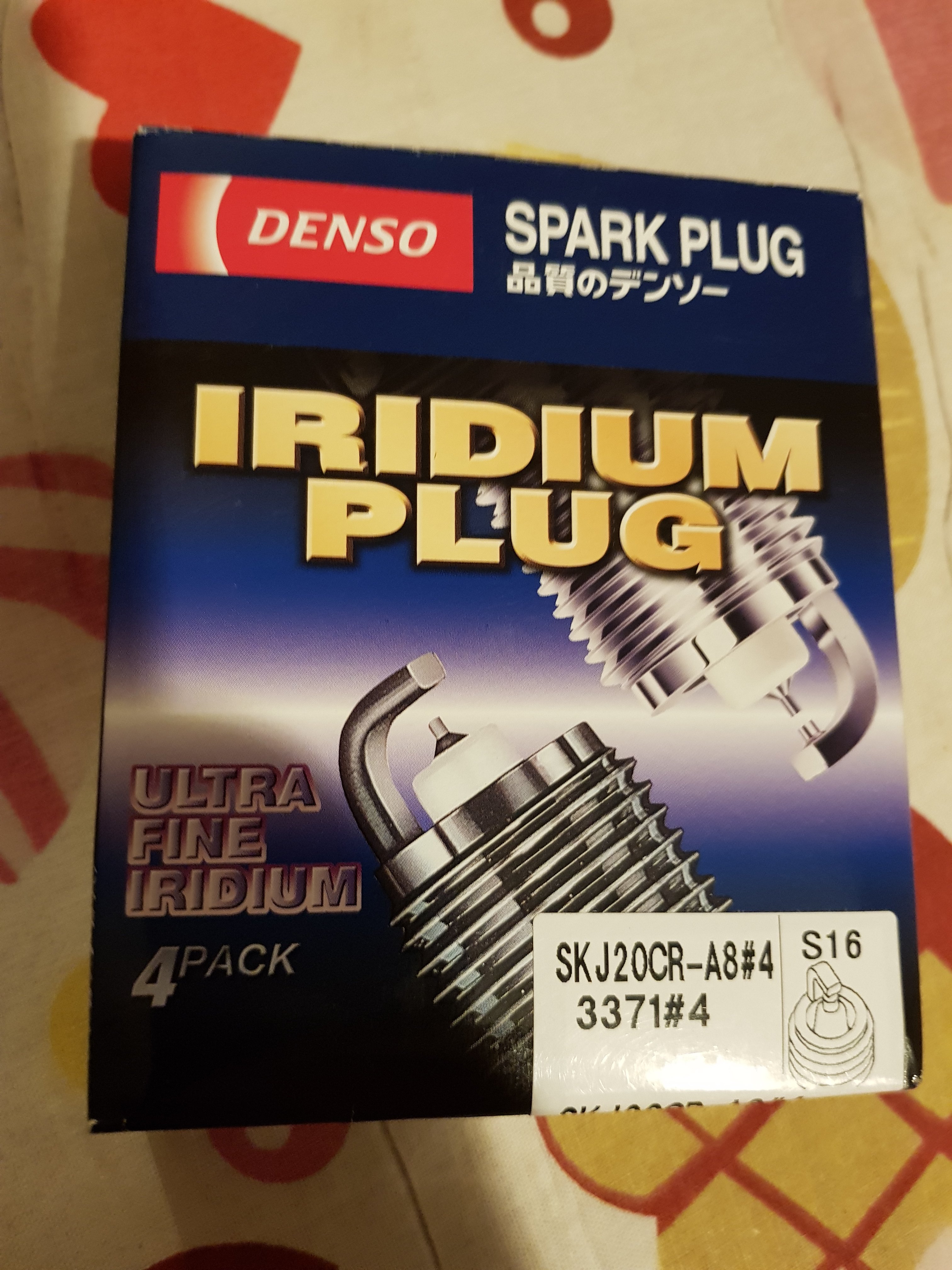

Just a quick question.
Ever since i change my plugs to denso’s it idles really lumpy on initial start up?
Mellows out after a few minutes...
i have noticed it runs (SOMETIMES) a little lumpy when at the lights etc etc.
Is this a concern i ahould be worried about or is it due to the bigger gaps on the denso plugs?
Regards
Did you get the SKJ20CR and from a trusted supplier.
If the 4 plugs are in and at 0.8mm they should not be the issue.
The car should start at about 1,100 rpm and drop to about 800rpm in about 40 seconds, but not be lumpy.
Hopefully your air filter is fresh, the pipes / breather pipes all on OK.

I would be sticking with the Denso plugs that i used and recommended for years in the many many Twincharger Spark Plug threads.
 Buy from a trusted trader whatever you are buying.
