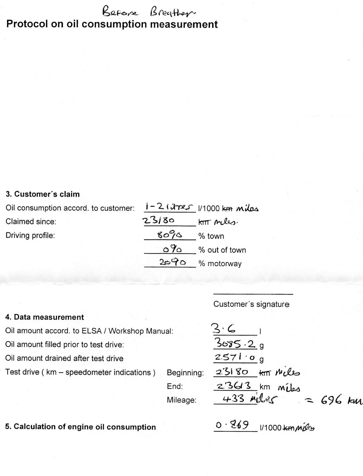

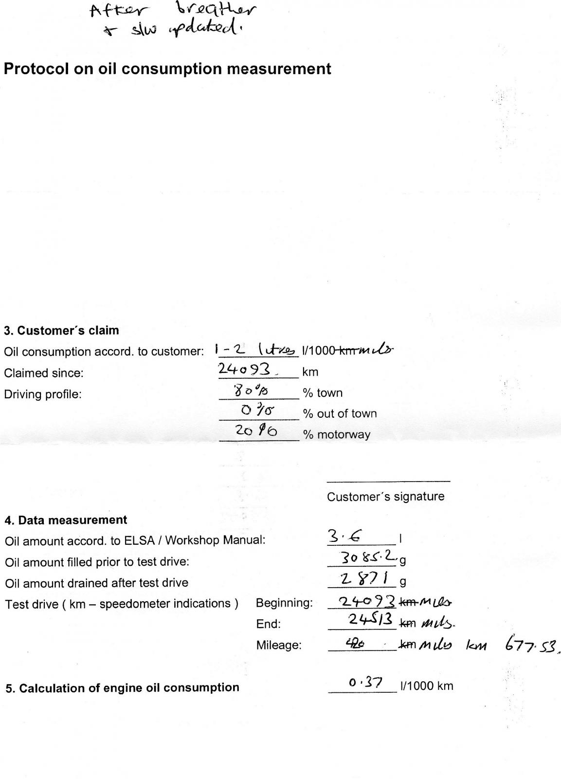

I've finally had my copy of the oil consumption tests after a long wait.
one is before the breather mod and software update and the one is after.
Thanks for posting.
Did somebody sign that and put their name to it as having done the test and written the report?
& Where does it show on the Dipstick with a Hot Dip & also with a Cold Dip when they put the car out with the correct amount of oil in.?
So it shows it used well over 0.5 litres in 1000 km . At first Test,   (514.2 Grams of oil used, 1 litre weighs 856 Grams.)
& less,
and within there Acceptable figure after the Breather Mod. (Extrapolated Figures,)
So the proof is if the Oil Usage stays lower in Real Mileage and usage over several months.
ie, Only 0.5-1 Litres for every 1200 miles covered.
You had best keep an accurate record of the oil you need to add.
george
After a hot dip it was just over cross hatched area, cold dip was up to the orange blob.
The 420 miles I did on each test was all short journeys and cold starts with no motorway driving. I've noticed recently that when I do motorway miles it hardly uses anything.
I take it they never charged or tried to for the test, it was an Oil User and actually still is.
Stuff checking Oil and topping up ever 2 or 3 tanks of fuel once a car is run in because they say it is an acceptable use.
Most of them usually use no or very little oil on long journeys thankfully.
You just need to keep track & records and see what happens over time.
That was pretty high oil usage pre Breather Valve Update.
Unlikely that there will be that much of an improvement over a period of time, but fingers crossed.
I am just a bit doubtful of their figures and calculations, but only time tells.
At least that person had the Oil weighing 857 Grams per litre.
Unlike the other members test where they had the oil Weight at start of the test as 1000 grams for a litre.
george
