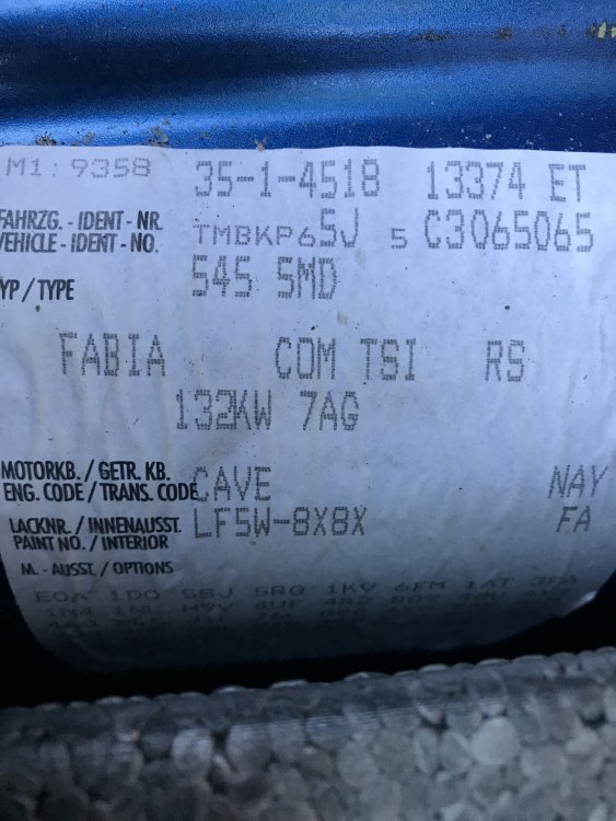

CAVE & CTHE 1.4TSI, Just reply please if you have had an engine replaced.
