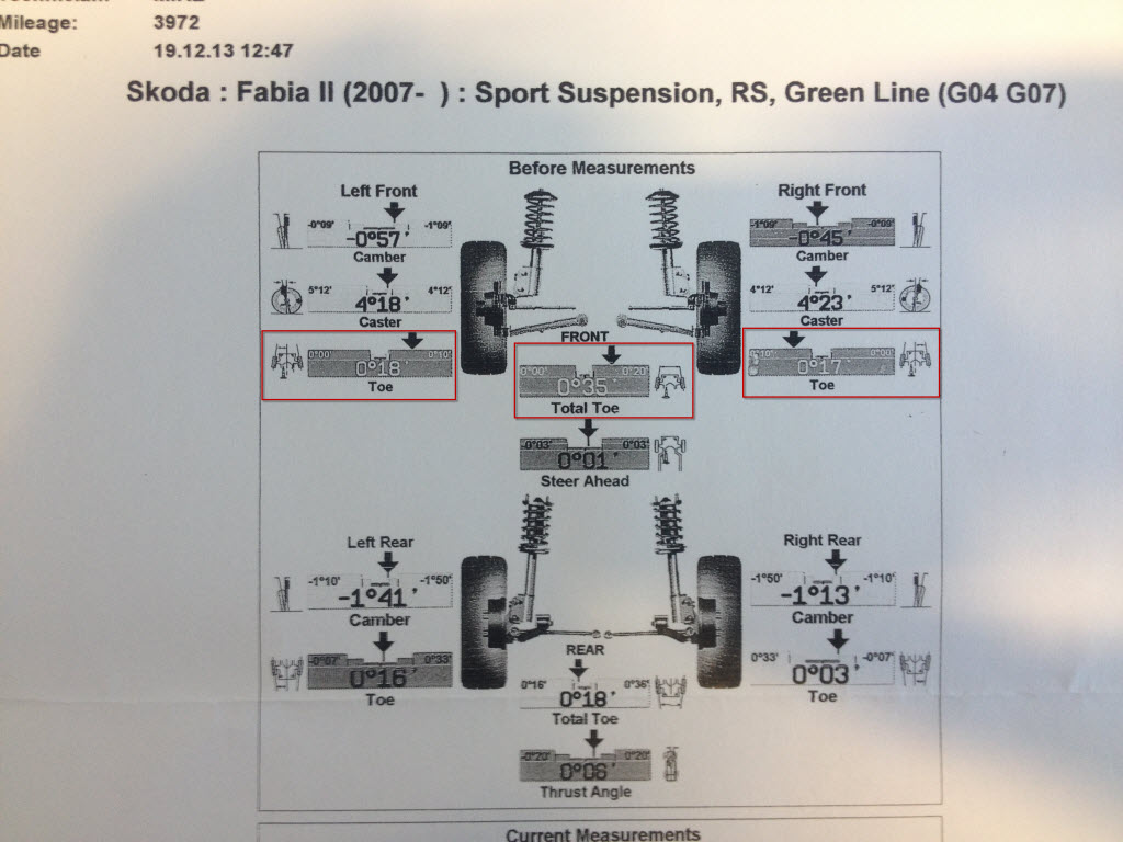

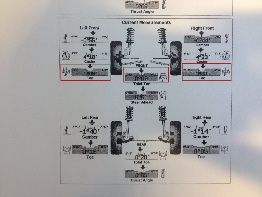

For info I had the car aligned indepently on a Hunter machine and it made no difference. Attached are the before and after results of that alignment. Only the Toe was changed
Edited by marky
