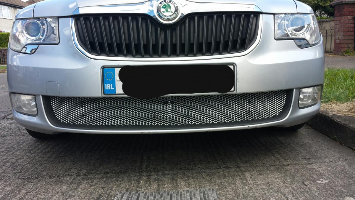

I done this on my car and posted pics on the facebook page. Some of the folk are saying that the air will now flow around the grill ( path of least resistance) and could cause premature fan failure. Any thoughts??
There are still holes for sufficient air to get through, as well as the upper grille which remains unimpeded.  Remember that this is a diesel, and a relatively low-performance car.  I have done the same with zunsport grille guards on my porsche and it is absolutely fine.

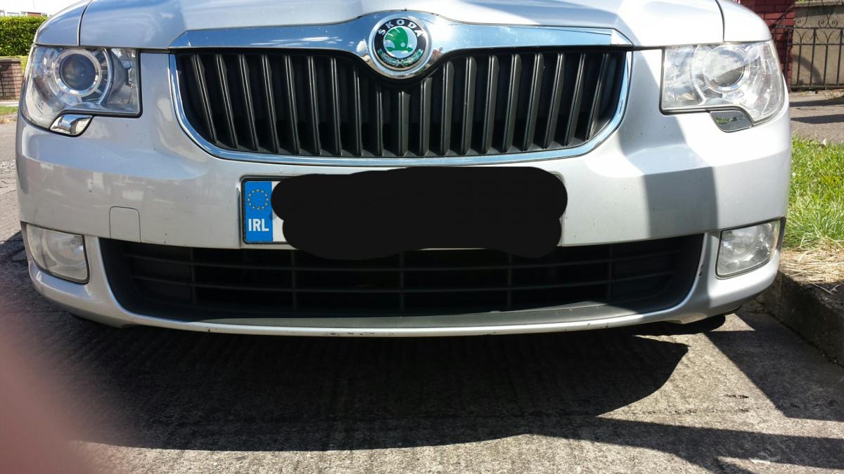

Before and after pictures.
I followed your instructions to a T, except for using the string. I found there was ample space when using longer cable ties.
Only one suggestion I would change is use light cardboard or even a piece of paper ( more flexibility)
As my Superb is a taxi I didn't bother with the rubber strip over the edges, plus I could only find something in blue.
