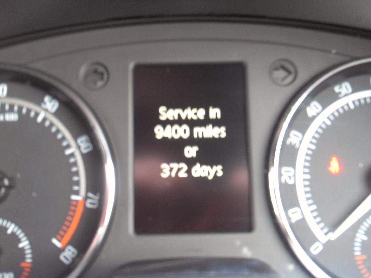

What did the car think it was on before going in for the service, was it counting to 9,400 miles to the service ,
what is it showing now.  372 days / 9,400 miles, or something else?
Think if it's done by the dealer it goes by oil life if you reset yourself think it pops up every 10k ?????
If done by the Dealer it can be set on Variable / Flexible or on Fixed as you wish.  Well where they do it properly.
When on 'Fixed' you reset as you want for another 372 days / 9,400 miles when ever you want.

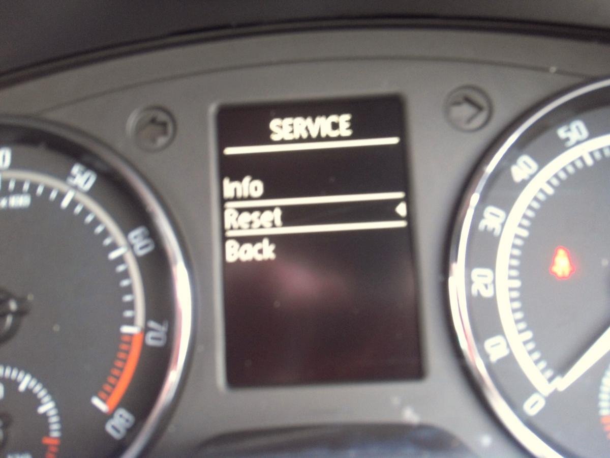

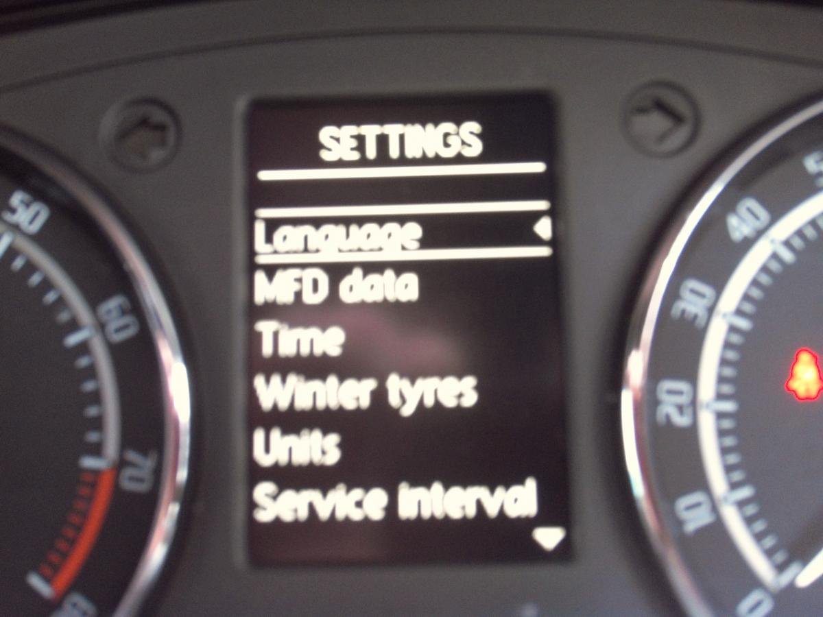

On mine its a simple case of holding down the button on the side of the right indicator stock and it brings up the settings menu in the MFD from there you scroll down the appropriate menu after that and use the button on the bottom of the same stalk to select the service menu.

With the car off, press and HOLD the 0.00 button for the odometer reset
Continue Holding the 0.00 button and turn the ignition key to on. MFD reads "Service Now!". Keep holding the 0.00 button and then press the MINUTE button for the clock set. Let go of everything and you're done
Note: you can only reset the service display/stats this way if its actually showing a service is due...also resetting this way puts the indicator into fixed interval mode (9300 miles/365 days)

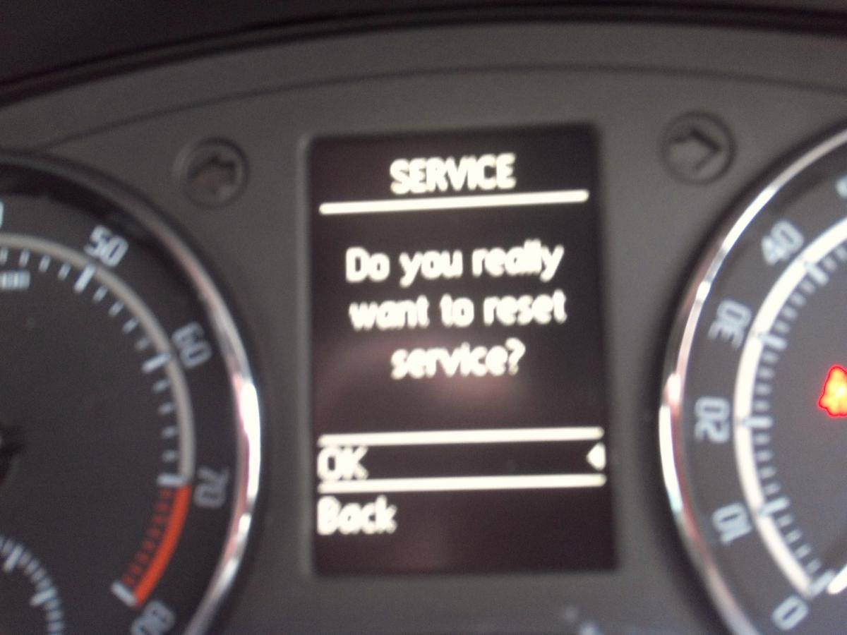

On 04/06/2015 at 11:35, tehany said:
As wacky is  it sounds - but it works! for inspection warning reset, do the following: activate the hazard warning lights, as it is on, press the 0.00 button, and turn the egnition on half turn. it will display the "are you sure message", and you should enter OK, and turn the egnition off and on again.
for oil warning, the same procedure without the hazard warning lights on.
Perfect. Thanks for this! Worked exactly as described for me last night.
