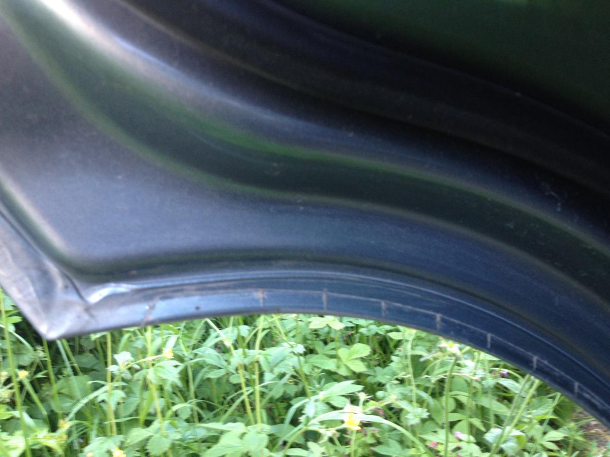

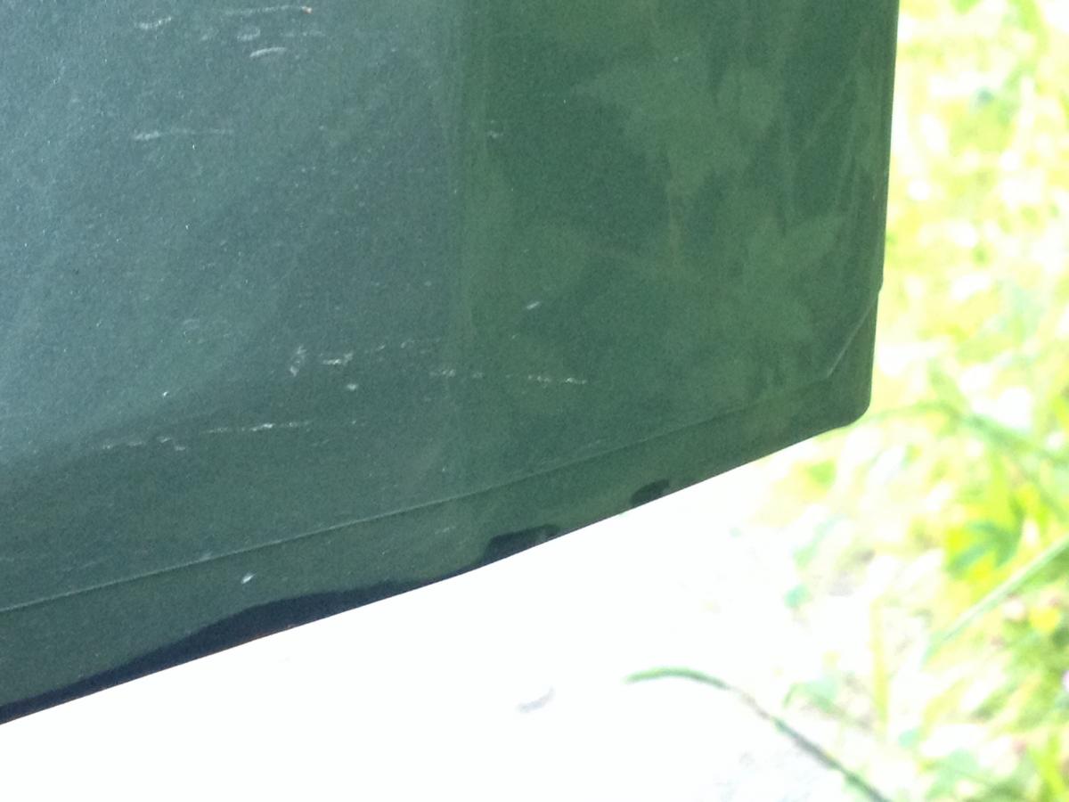

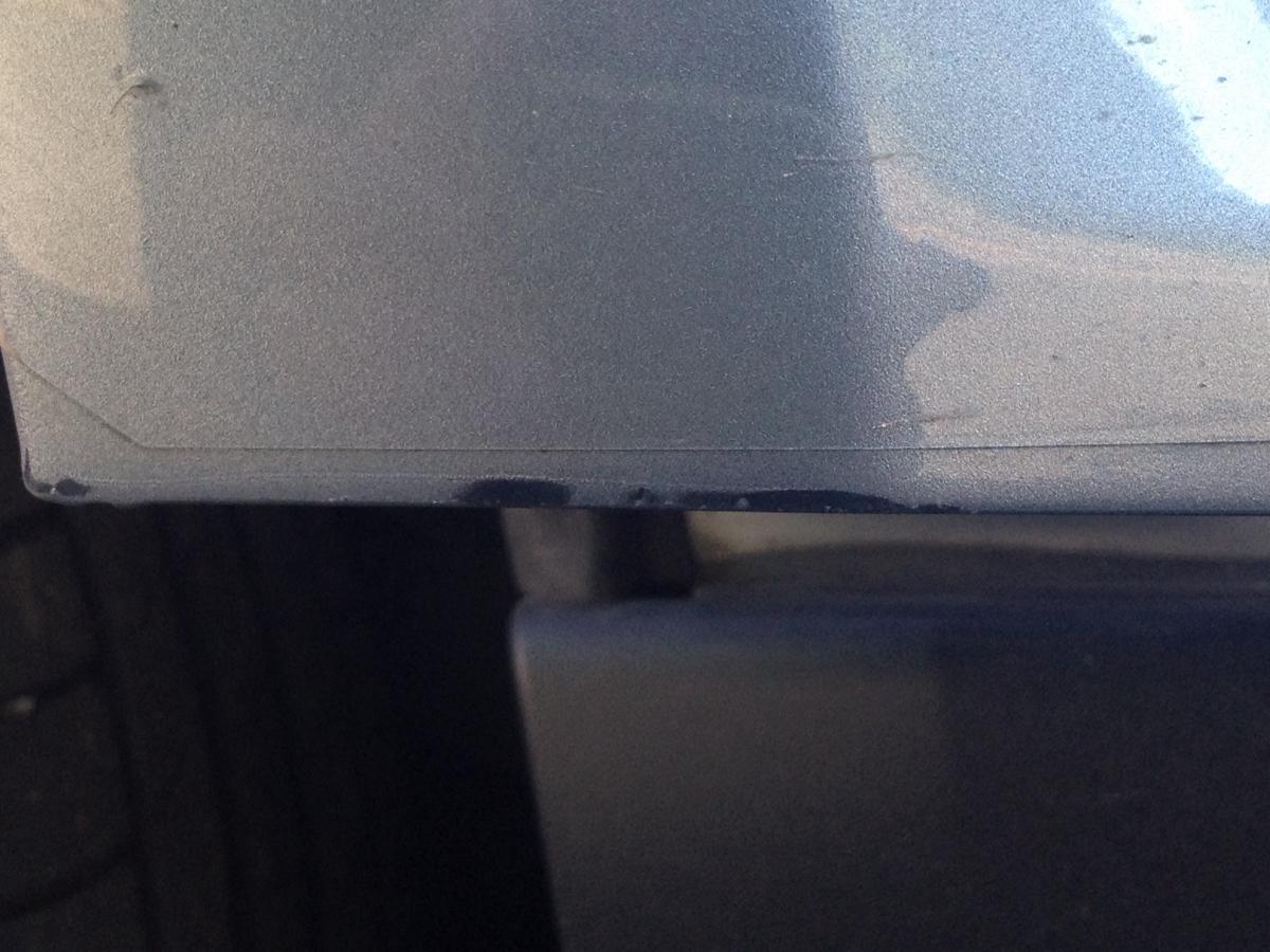

Here's the inner edge of the foil:
But I have other issues:
Black patches along the bottom edge and a line left from the first replacement foil they didn't fit properly on one side.
The black bits look like missing paint. But how & why I don't know as they were not there when I inspected the vehicle upon collection.
I'm wondering whether they tesprayed the whole door as promised...

We had the same on our last Yeti following warranty paintwork.  The bodyshop told us it was something to do with a problem with water based paint.  Needless to say they repainted the affected area with no argument.
