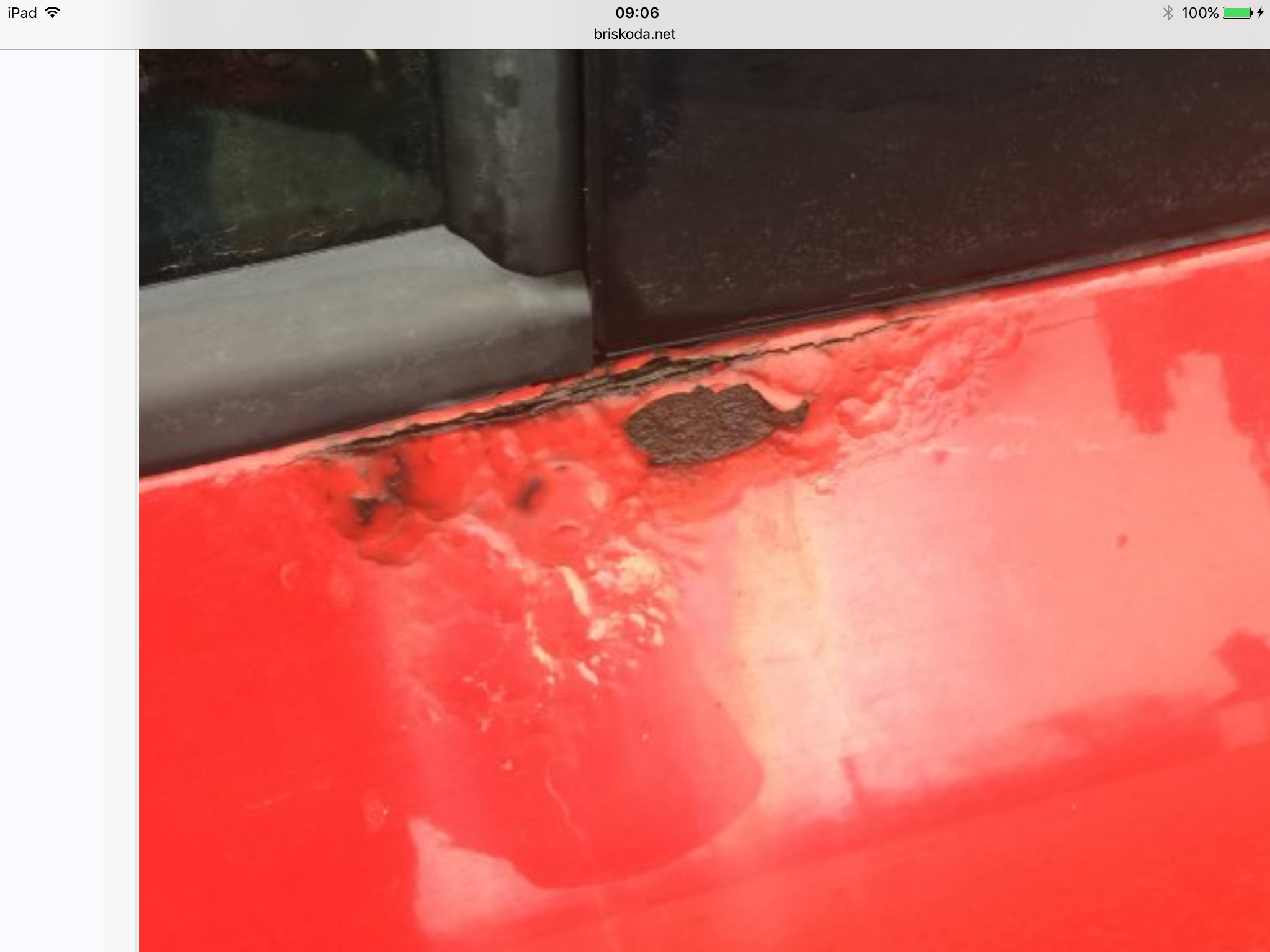

Was this it,don't know if this is rust or zinc inclusions
That is the one.
Even the biggest Yeti fanboys can not just ignore things like that,
even though they have great service and no issues other than the odd 'Paint Repair' Broken Rear Spring and other bitsand pieces that are just one of those things.
This is an extreme example of rust on a modern car. It must have developed over a long period of time, it can't have gone un-noticed at dealer servicing surely - why was nothing done about it at an early stage? Looks like neglect/poor servicing/ corrosive atmosphere - other causes are available!

^^^^^ That post and thread was a totally odd one, and nothing to do with the usual and common bottom of the door issues.
But there was actions taken, just stange.
