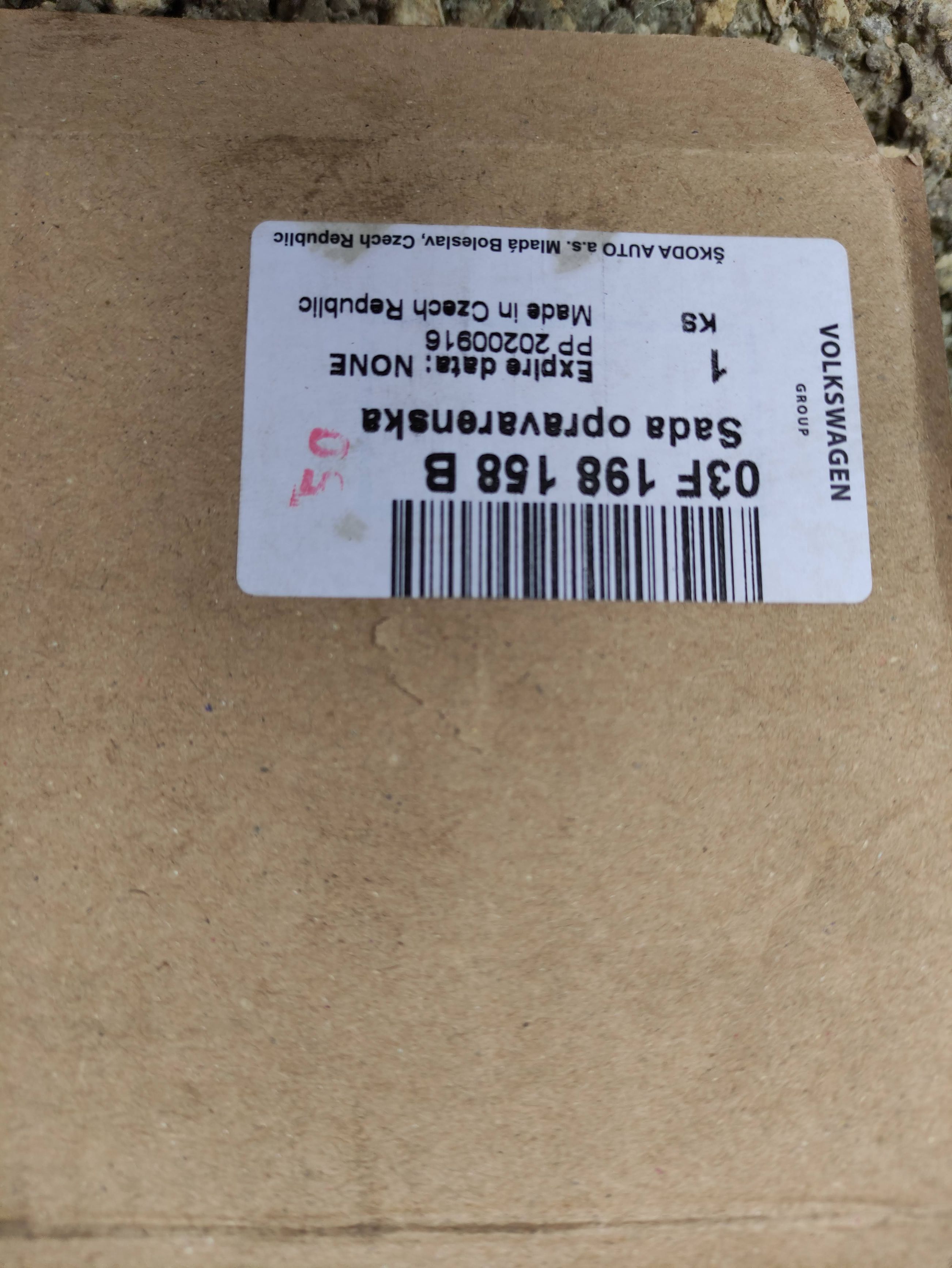

Many thanks for all the information above I am getting really confused by this.
I have got a quote from a local garage which used to be skoda approved isn't anymore claimed the skoda franchise cost to much. Anyway the part they said would be needed for a timing change change are listed here:
03F109158G – TIMING CHAIN
03F109507F – TENSIONER CHAIN
03F109469E – TRACK
03F109509F – GUIDE RAIL
03F109571F – SPROCKET
03F115225 – DRIVE CHAIN Oil pump
03F115121B – SPROCKET Oil pump
D176501A1 – SILICONE ADHESIVE SEALANT
D176600M1 – SILICONE SEALANT
N90256202 – SCREW HEX HD
N90987302 - 12 POINT SOCKET SHOULDER SCREW
N10734501 – 12 POINT BOLT (COMBI)
N10734401 – 12 POINT BOLT (COMBI)
N90365901 – OVAL HEXAGON SOCKET HEAD BOLT
WHT004068 – SUPPORT BOLT
03C115561H- OIL FILTER
The ones highlighted in bold are contained in the kit 03F 198 158B I think. However the parts list they provided doesn't include 03F 105 209G crank sprocket I asked why not and they claimed that that part wasn't applicable to my car and that it was a none replaceable part.
I would be grateful for any thoughts on this.

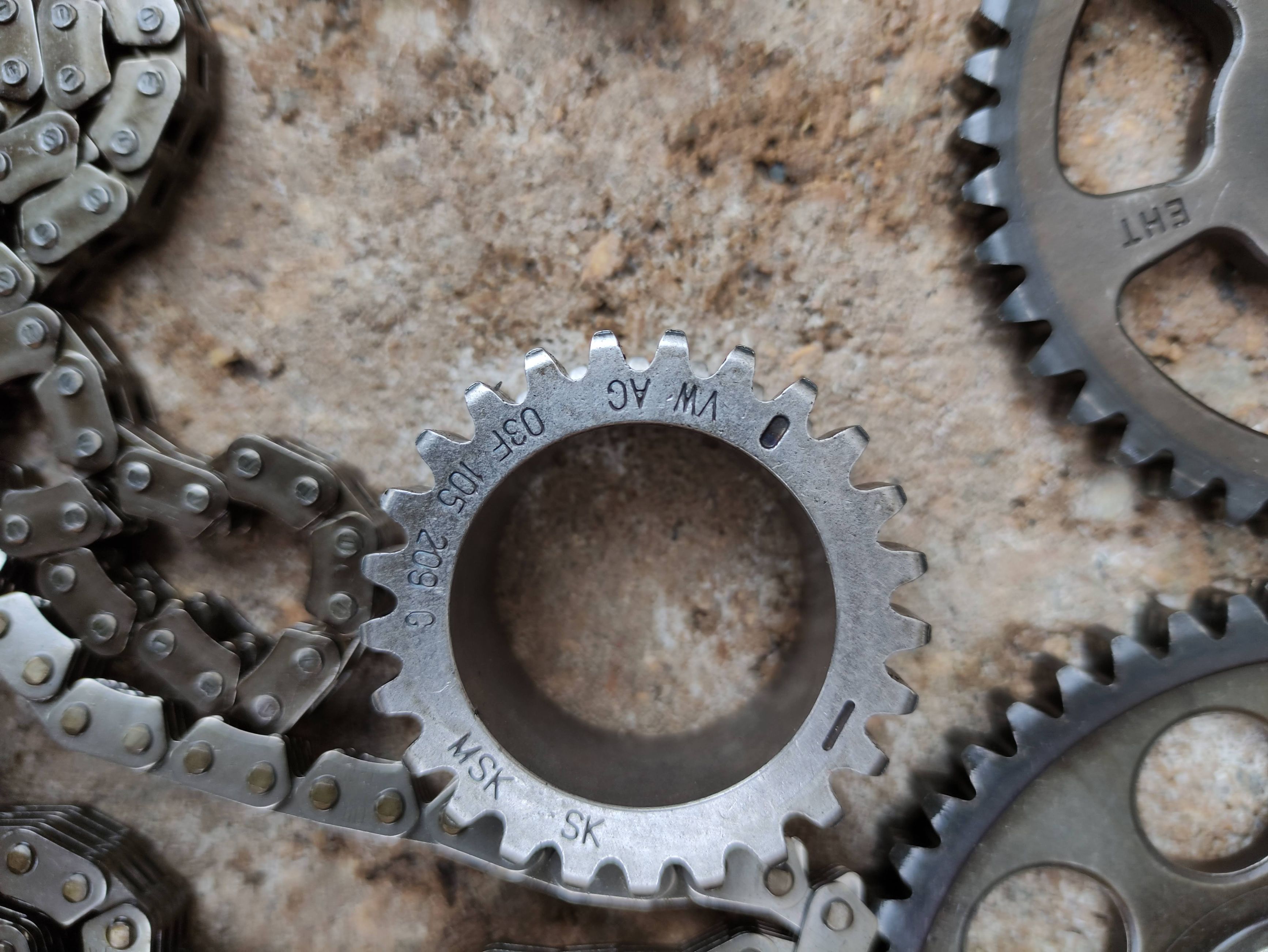

Your engine is clearly post-VIN split due to the date of manufacture.
The garage has therefore made an error and assumed yours is an earlier engine with a non-serviceable crank sprocket.
You must insist that the crank sprocket included in the kit is fitted, make sure the parts list is amended to reflect this.
The crank sprocket wears the worst due to being half the diameter of the cam sprockets, a new chain will not sit properly on an old, worn sprocket.

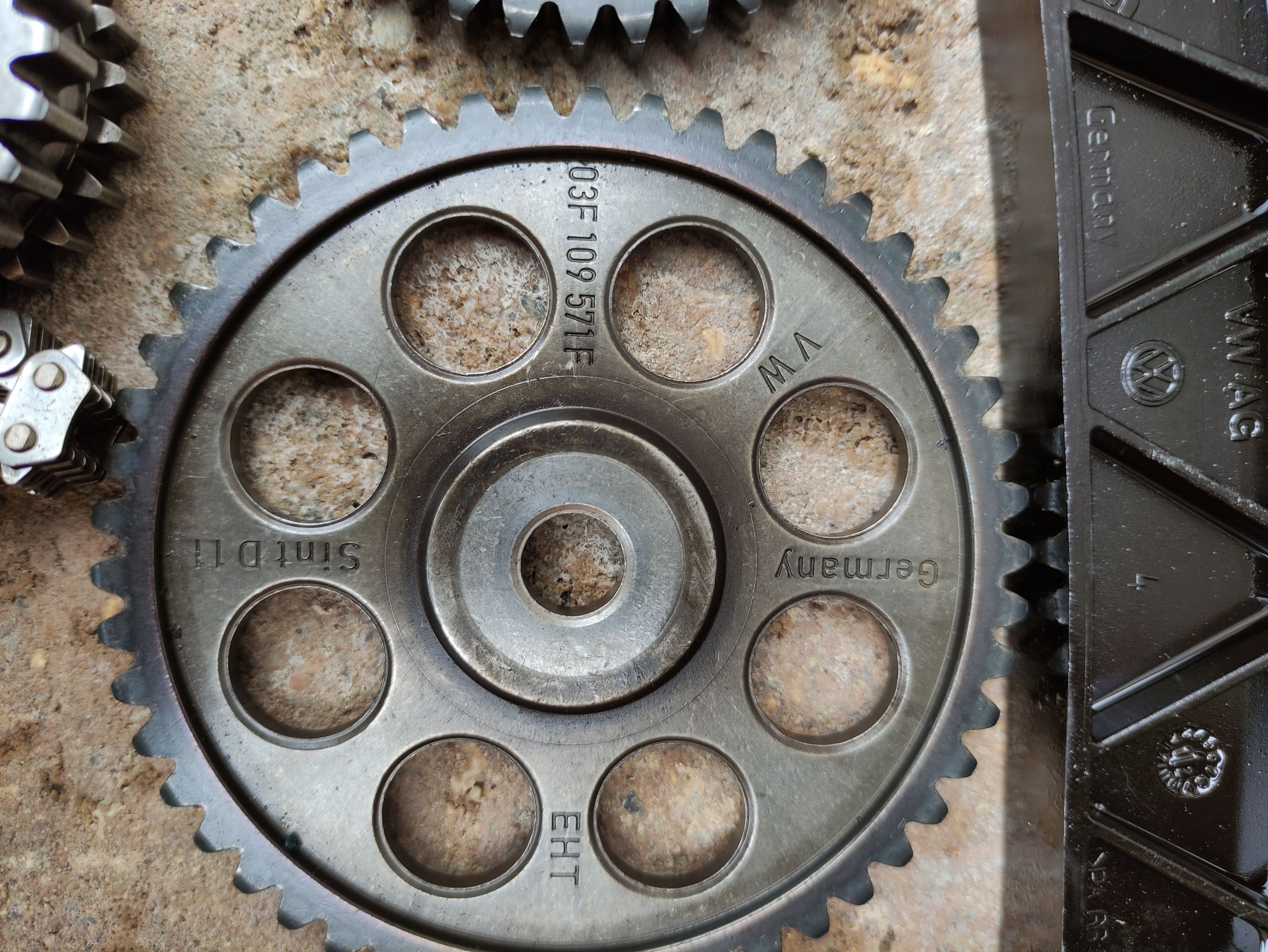

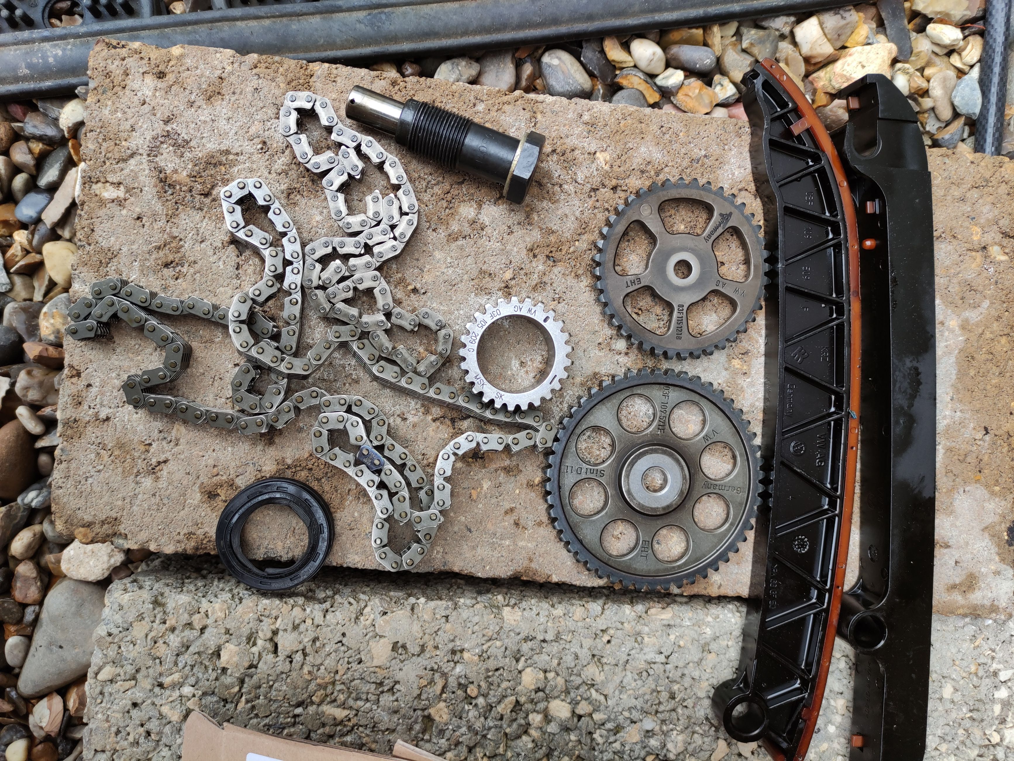

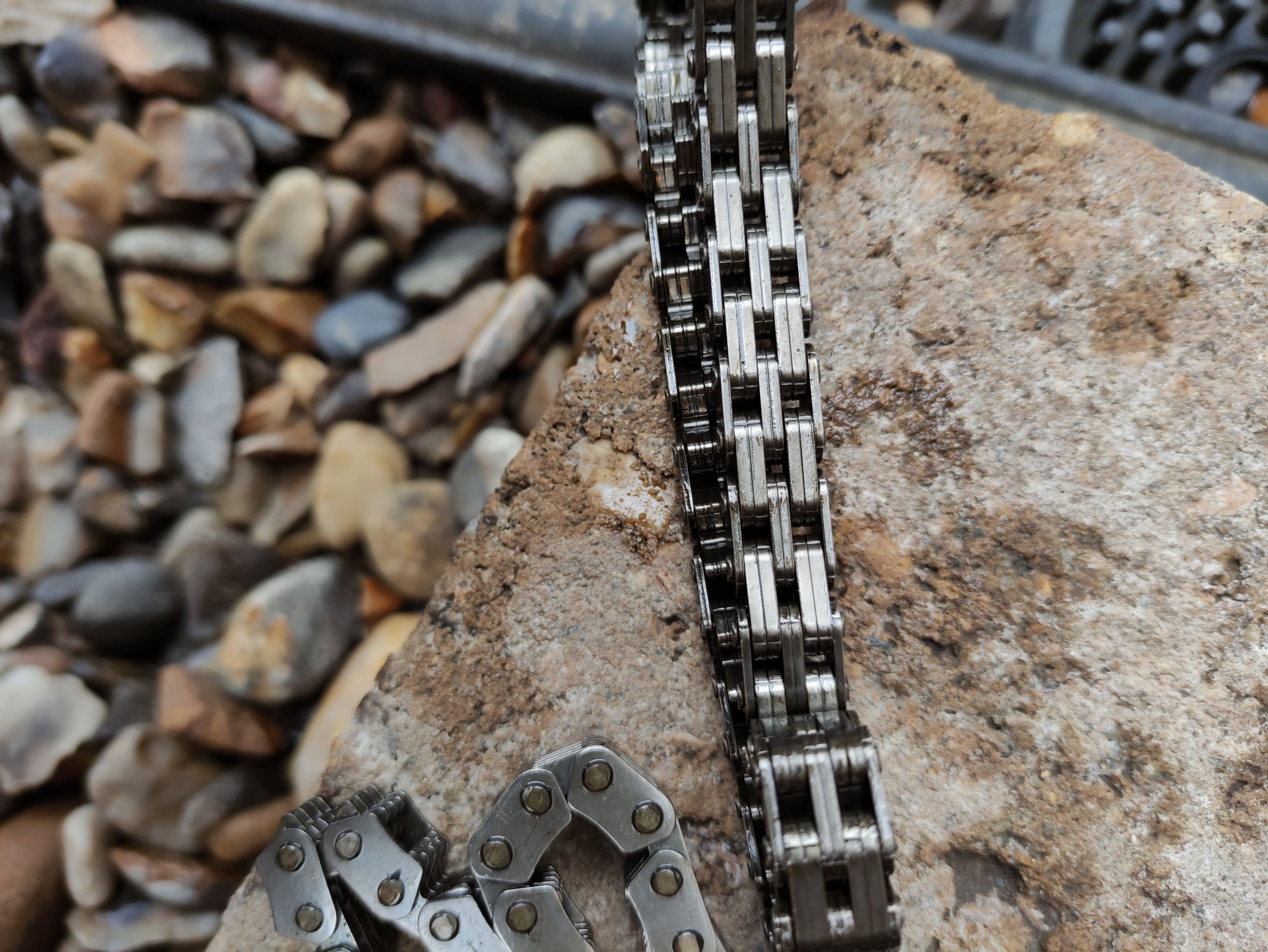

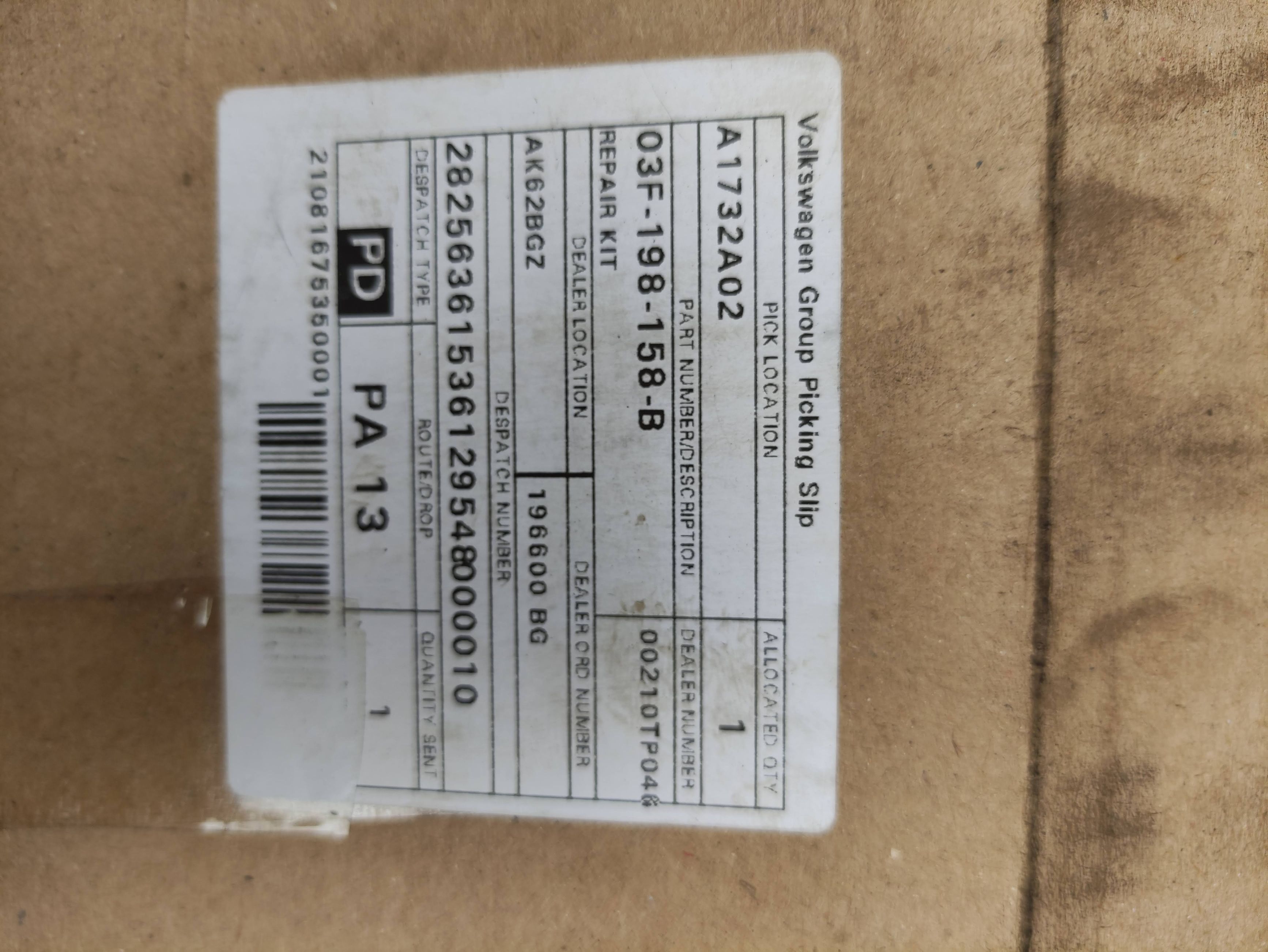

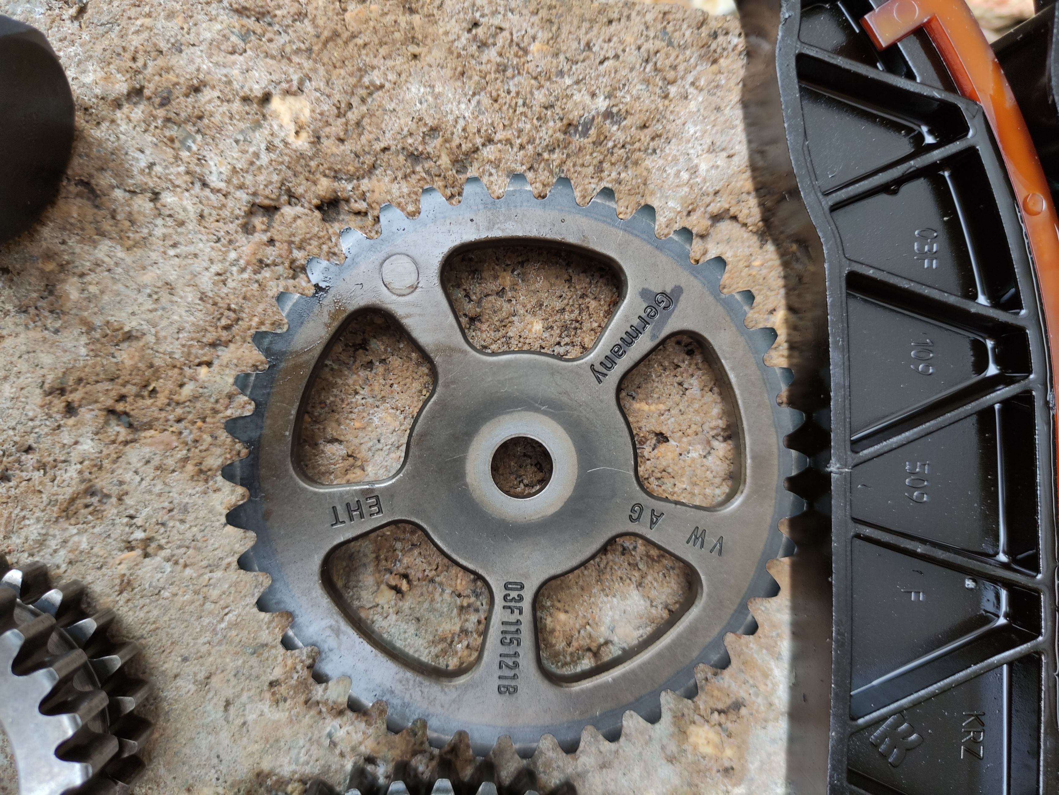

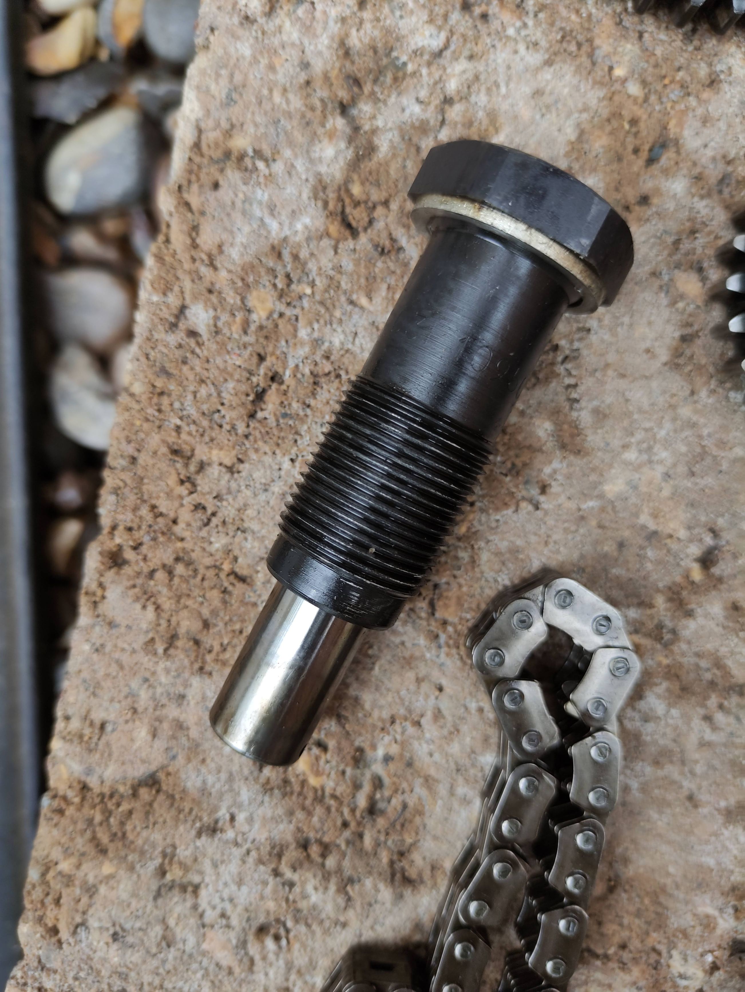

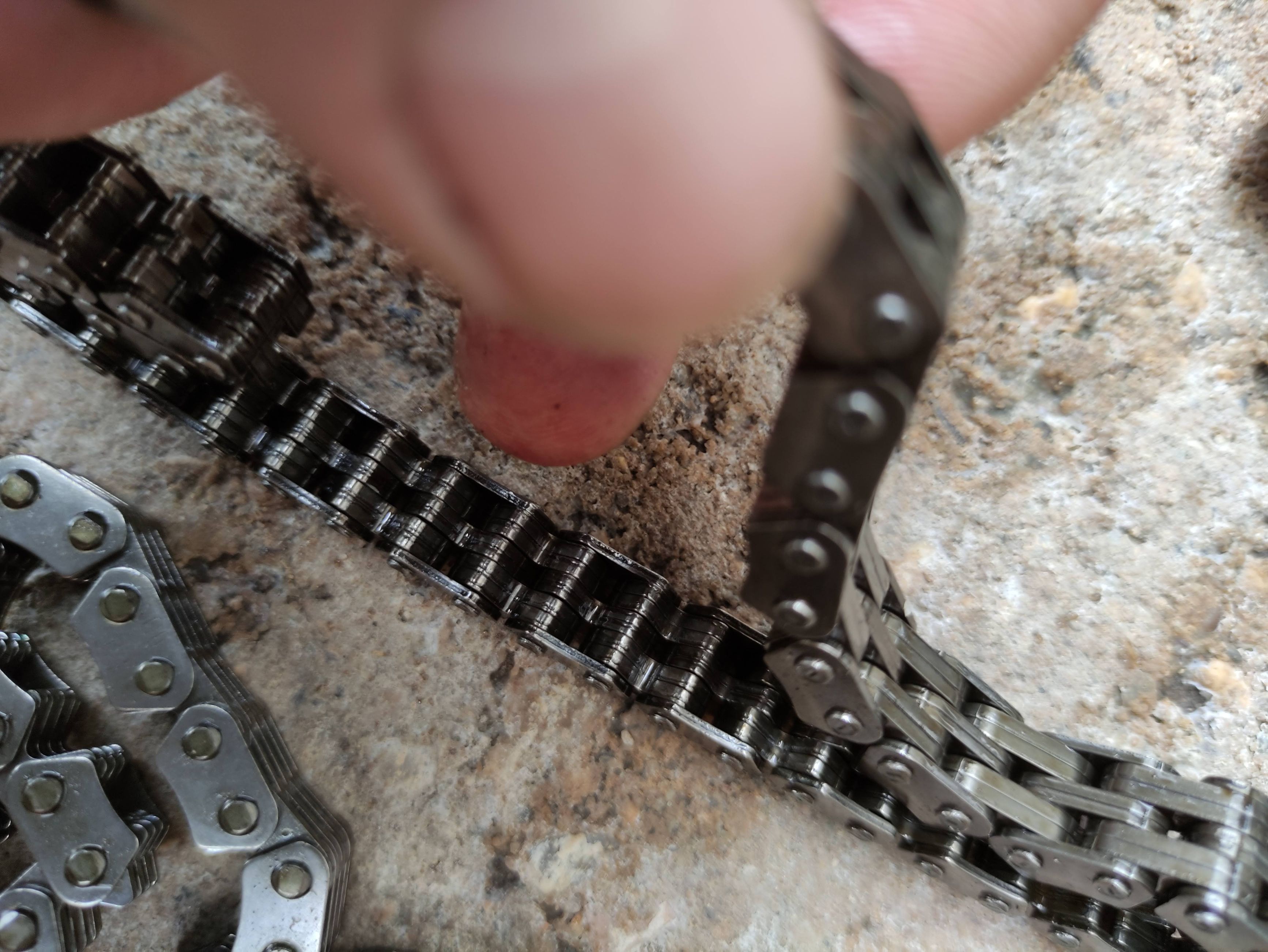

Hi, in the end I got the job done at https://adsutton.co.uk/ in March Cambridgeshire. This was only done a couple of days ago, but the communication from the garage was great and they were very clear on what parts were being replaced.
They charged 5 hours labour in the end to replace the chain.
I asked them to keep the old chain etc photos below. As my car was main in July 2012 it had the new 'improved' chain. Hopefully I won't have to get this replaced again.
