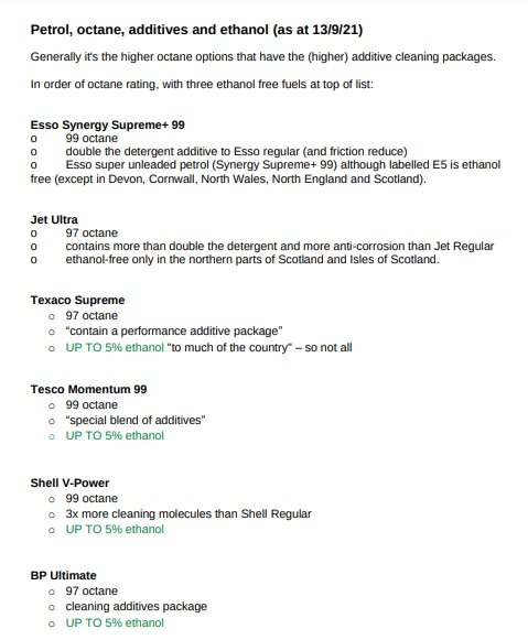

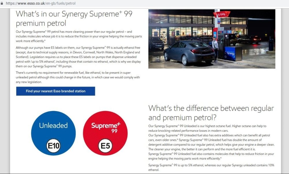

There's a very interesting article on www.groups.tr-register.co.uk/wessex/ethanol ,concerning what the ever increasing levels of Ethanol in U.K and the Eurozone fuel are doing to car engine internals and other ancillary vehicle components.Especially in vehicles with older style engine sets ups.
Edited by faradaycage
