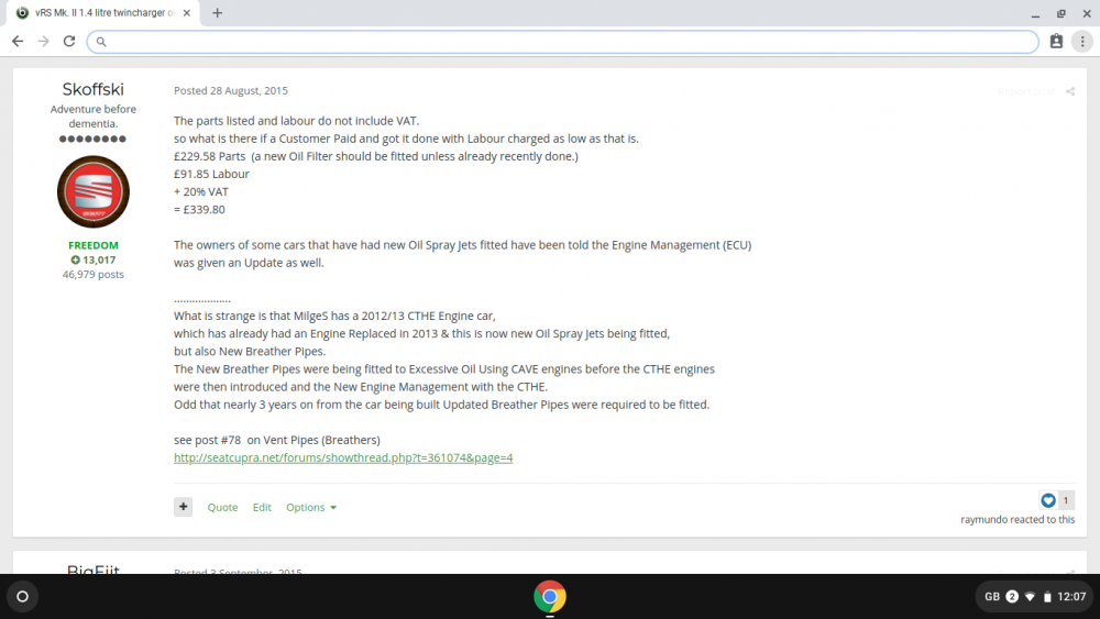

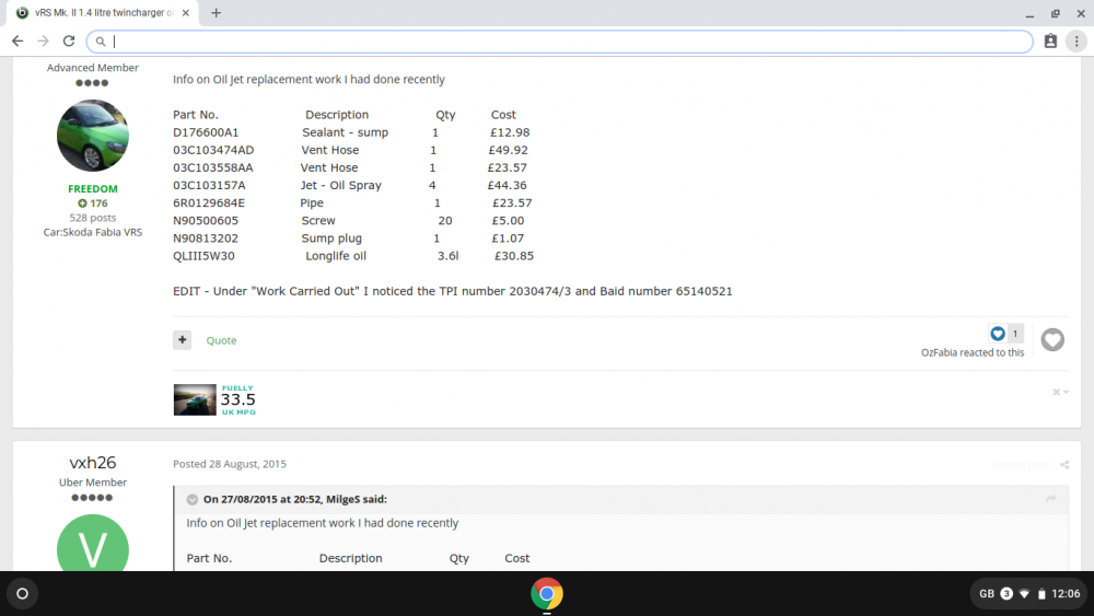

Does anybody have an invoice for this work with a price on it?
Parts under £150 including New Oil & Filter (if Required)
(& a Main Dealership can have a car in at 8.30 am & ready for collection by 2.00 pm. eg, as done on wesleyuk's engine.
so 4 hours @ £60 an hour plus VAT.
Under £450 should do it.
Best get a quote from a Main Dealer.
Edited by goneoffSKi
