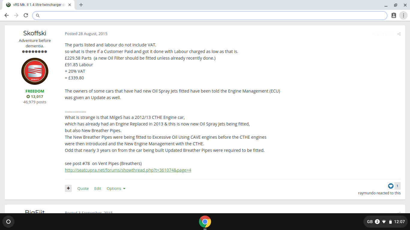

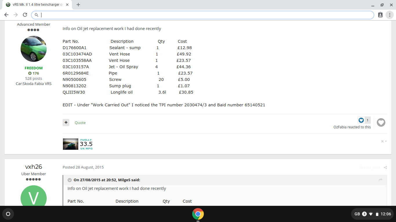

Jets and a software update.

this was an itemised bill of mine 2.5 years ago. there was definitely some sealant missing as i found it on another post.
