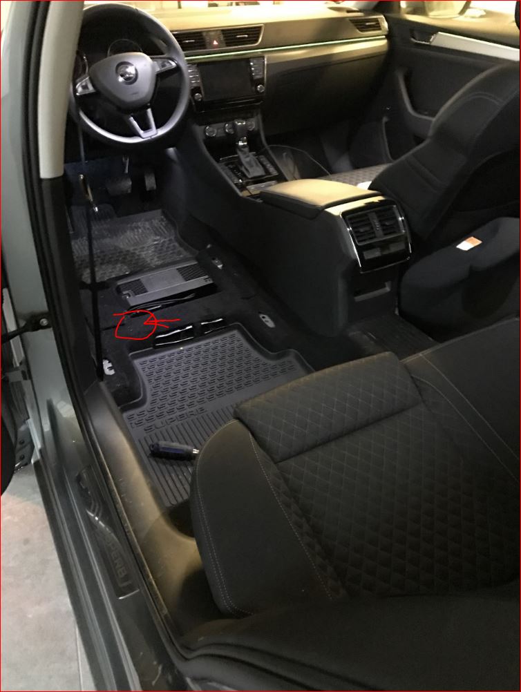

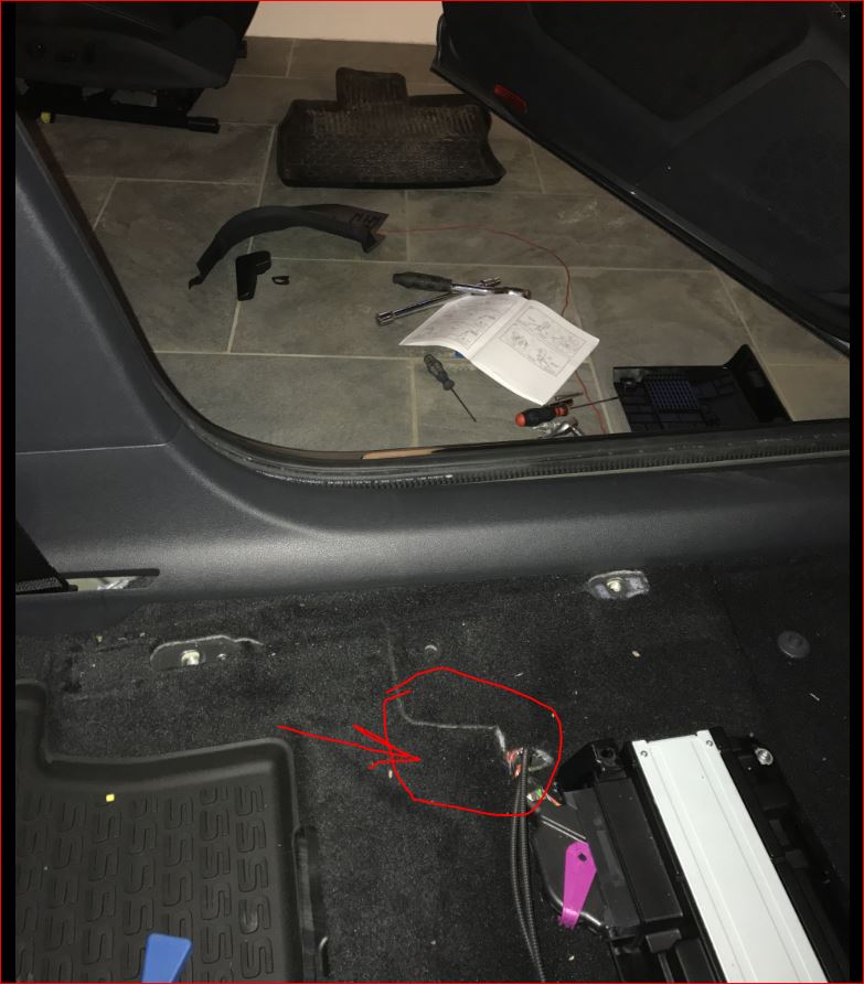

Í installed my Smartgate myself and it is very unhandy to get to under the drivers seat. To install the unit and wiring we had to remove the drivers seat, the trim on the footstep of the driver side, the footrest, the knee airbag and a warm air channel under the steering wheel.....and still it was one hell of a task to install the wiring.
If you just need to unplug the Smartgate unit you would probably need to take out the drivers seat and you will find the unit behind the Canton amplifier. You may be able to get to it woth out taking out the seat but you would need to be extremely flexible :).
In the picture you will see my car iwth out the front seat with a red marking where the Smartgate unit lives beneath the carpet.

And the view to the home of the smartgate from the backseat
Great post @MikkelF! - I will do a bit more investigation, and then see if my other half is willing to be flexible enough to pull the lead out...
Many Thanks. A
