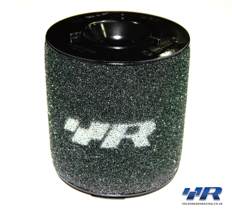

Anyone here have a K&N filter fitted to their vRS? I presume the filter is the same as the Polo GTI one?
If so was it an improvement?
Best not go for a K&N replacement filter with a 1.4 TSI 132-136 kw Twincharger unless you are concerned about getting the filter wet,
it will not help your engine breath better or improve performance.
Used the VWR replacement filter before . Very small gain but compared to the price of a proper cold air intake upgrade it is worthwhile until you get a tune done and then you should upgrade again.

Is this filter oil based?
They are just Foam style filters,
not like Coated K&N (re-treat with correct treatment rubbish filters)

What he said. They use the original VW plastic part of the filter minus the paper element so direct swap.

Pipercross do a filter like this for our cars too and it's about £40-50. Can't imagine it's much/any different to the VWR one

They do one that looks similar to the VWR one for £59.99. Still debating on whether to get one or not..... :D

You are as well with the Standard Filter or get a Induction Filter that does give improvement the Revo/VWR will do little to improve performance
other than cost you money. (actually give no improvement IME.)
