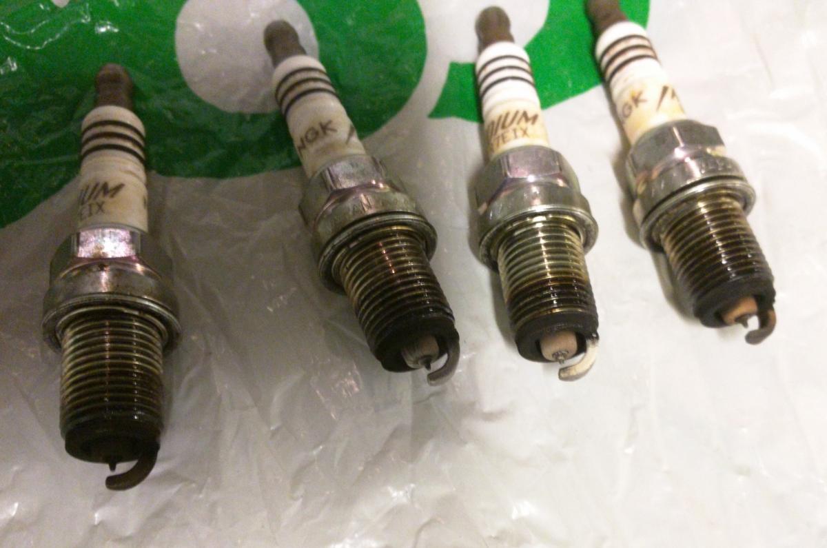

Mine are now shot after 12k.... (NGK7's) going to use the denso's next... at 0.6mm gap..

Lasted longer than mine which were shot after 5k miles haha, currently running whatever the standard skoda ones are, changing to the denso before we go away next year.
"Shot" like? Any photos of how they were looking? mine did 17K km (a little over 10K miles) and were still looking like that:
Not too bad, but 2 of them were a bit white on the sides...
I say shot, I was away on holiday and the car started misfiring while under load so I just took It to the nearest skoda dealer and they changed the plugs under warranty. Didn't have a chance to see what they took out not the part number of what they put in.
