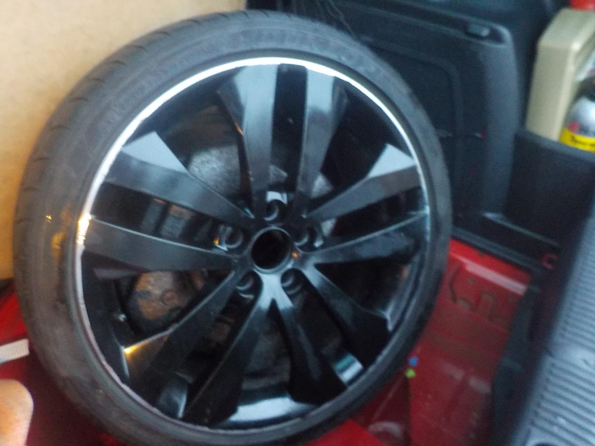

I carry in the spare tyre well a 215/40 R 17 tyre inflated on a Gigaro rim and the floor sits flat in a Fabia vRS.

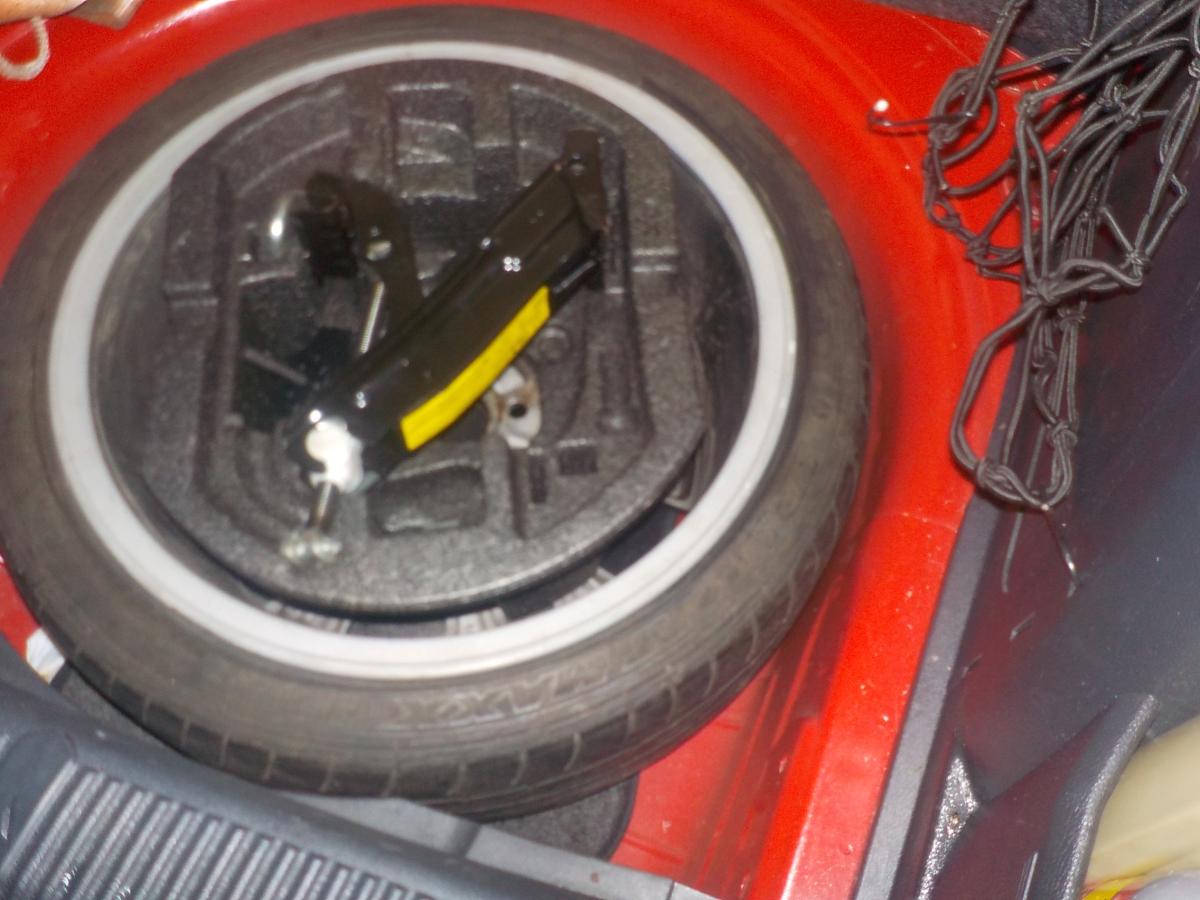

A 205/40 R 17 Pirelli Zero Nero fits in and has plenty room, i have tow straps and stuff around the tyre
& a Tool Carrier in the wheel..

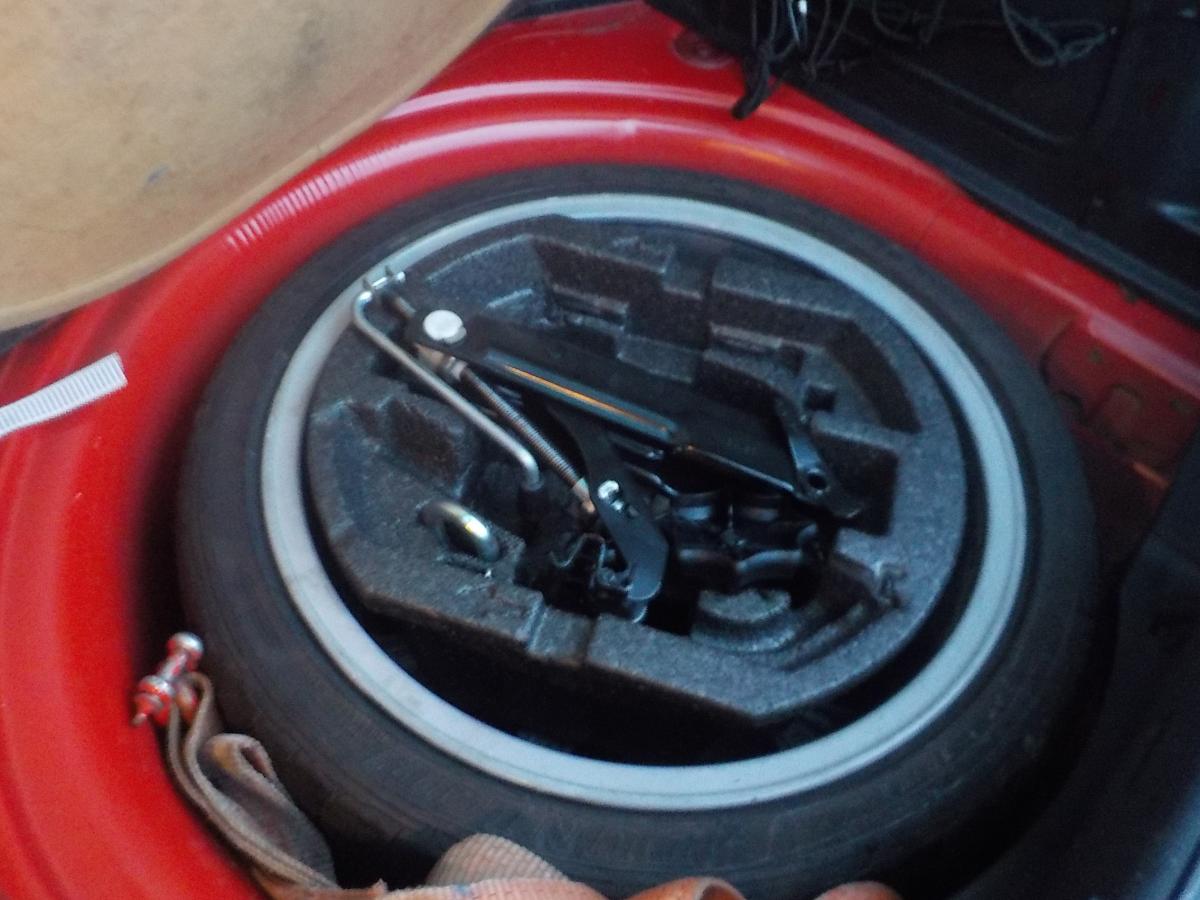

This is a Dunlop Sport Maxx 205/40 R 17 in as a spare.
