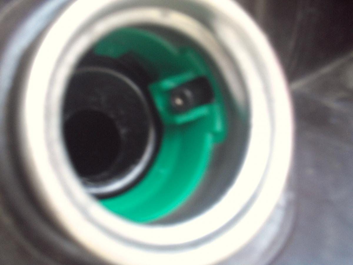

The thing to do is. look at your Fuel Cap, and look at the Slide you vent with.
When you fill up just normally, brim or what ever, and replace the Cap and turn then lock in place, the slide is pushed, it has vented.
sorry to have to make you elaborate George. So you're saying that the fuel cap makes the fuel system vent anyway?

The thing in the filler tube is not intended to be user operated, ever. The fuel cap, when screwed on, is what is meant to press on that, and 'unpress' it when taken off.
That's why there's nothing in the user manual.
Easily done accidentally though, and so a design that is a little questionable.
I found something about the system in an SSP a while back, it's all a cunning way of keeping fuel vapour (a strong generator of smog) inside the tank/charcoal canister system while and after refuelling. I'll see if I can re-find it later.
